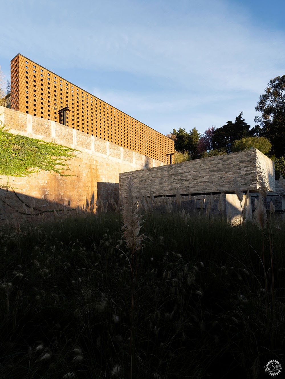

乡建八式 | 基于云南大知闲闲民宿改造的乡建实践第1张图片
▲西南侧远景透视©阮晓舟

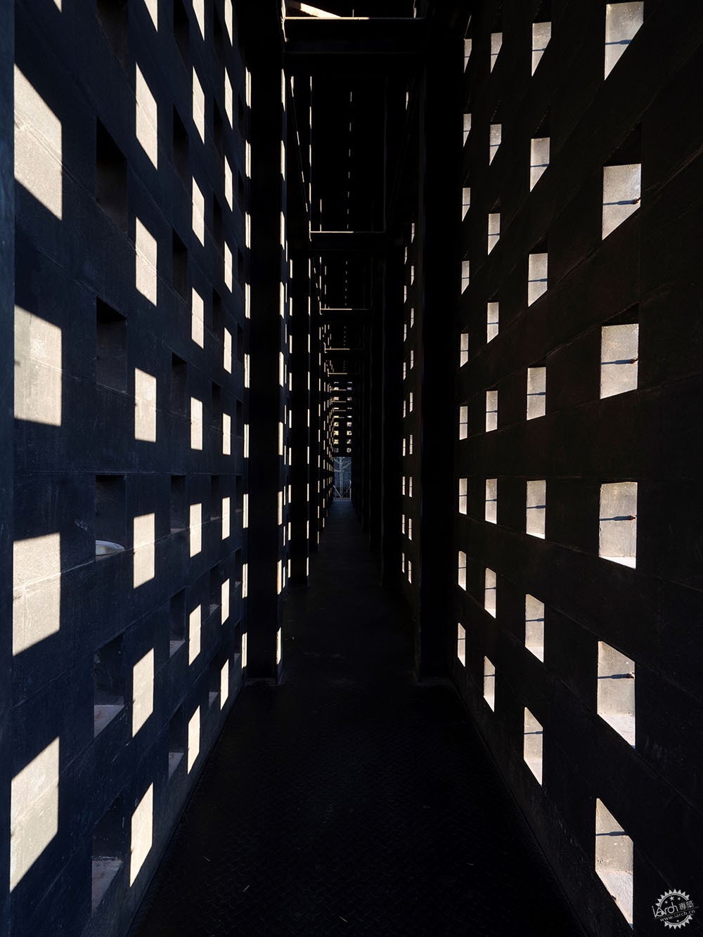

乡建八式 | 基于云南大知闲闲民宿改造的乡建实践第2张图片
▲沿街面透视©杨文龙
项目原始建筑为一栋三层半框架建筑和4栋双层砖混结构别墅,以及少量一层附属建筑物。建筑面积2457㎡,场地面积7790㎡,原有业态为价位低廉的普通农家民宿区。下文重点表达三层框架建筑砖楼的改造策略,以及新建浮居、土屏、幽篁里和雨亭、瓦亭、坡亭,微改造建筑原墙,呈现八种样式的改造策略输出,乡建八式强调了对乡土改造策略的思辨。

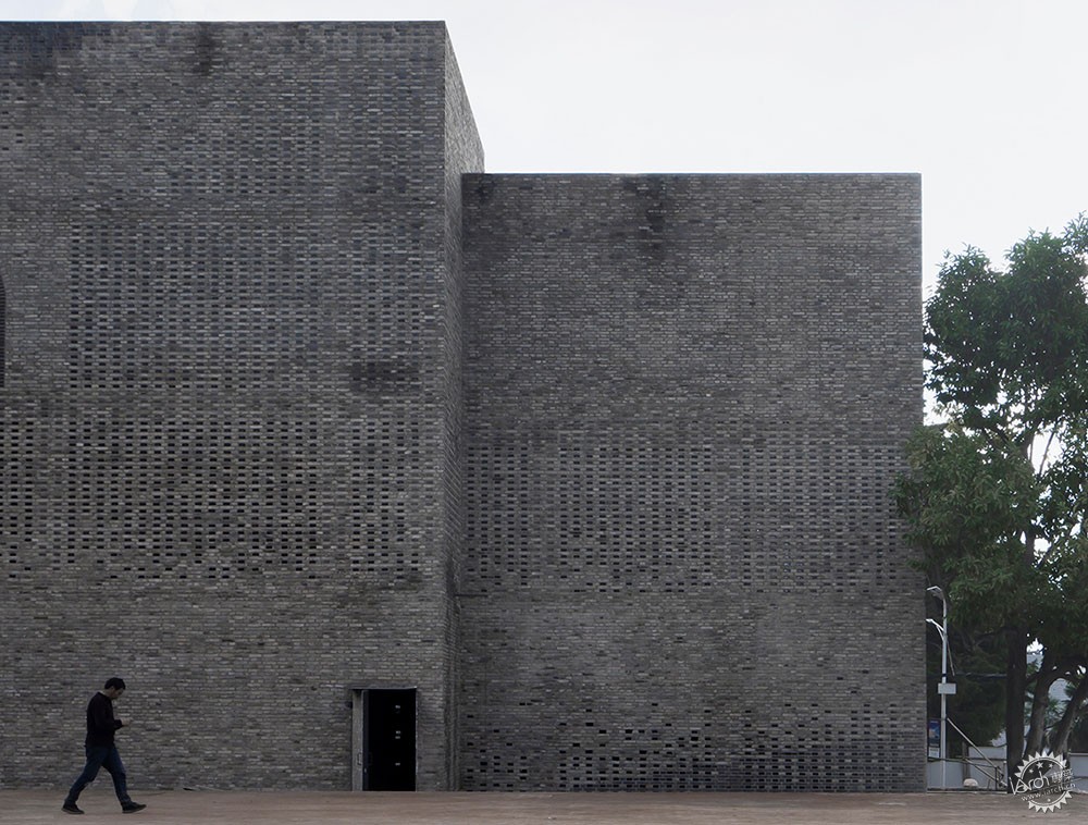

砖楼:诗意栖居
The Brick House, to Live in Poetry

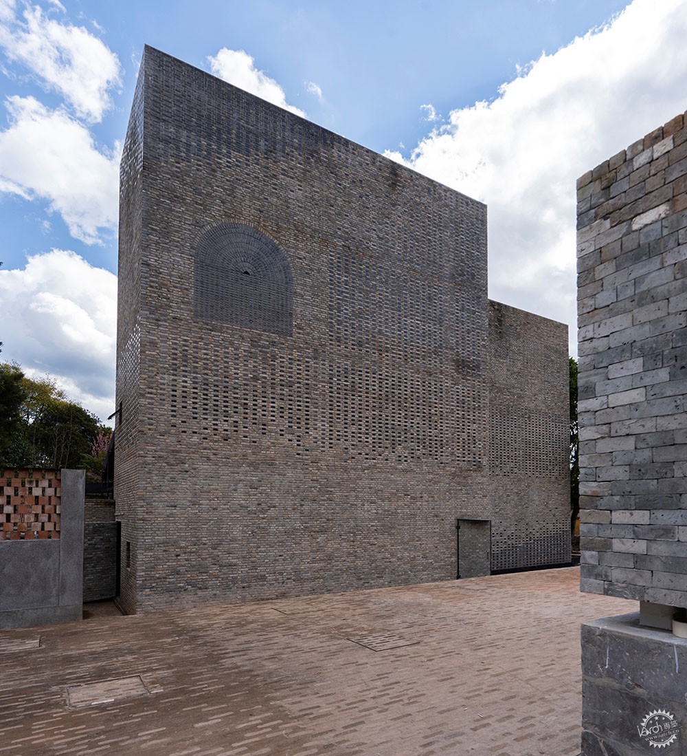

乡建八式 | 基于云南大知闲闲民宿改造的乡建实践第3张图片
▲沿街主立面透视©杨文龙
建筑现状和改造功能
砖楼为三层半框架建筑。原建筑开大玻璃窗,填充少量红砖,外立面贴白色小瓷片。由于改造后民宿功能的调整,全部敲掉填充材料保留原始框架梁柱结构是最直接的方式。这也引发需要重新考虑合适的墙体材料和构造搭接。

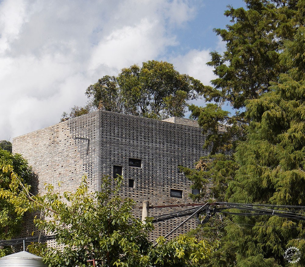

乡建八式 | 基于云南大知闲闲民宿改造的乡建实践第4张图片
▲西北面透视©阮晓舟

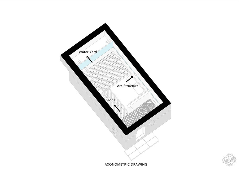

砖楼位于本案项目入口位置,也是街面形象,砖楼是整个项目离湖最近的建筑,最适合直观的感受到水文化。在场地语言上,我们创造了一系列入口驳岸的路径,并把水引入建筑周边,让建筑更“靠近”水岸。 本地“车水捕鱼”文化的竹篓形态给了我们建造表皮的灵感,篓的透光可以创造自然的渗透,其编织的做法也可以形成构造特征,对应到建筑本身,建筑以旧青砖和透明玻璃砖的编织机理成型。
Site Dialogue
The brick building is located at the entrance of the project, and it is also the image of the street. The brick building is the closest building to the lake in the whole project, which is most suitable for intuitively connecting with water. In terms of site language, we created a series of paths to the entrance revetment and design water surround the building to make the building ‘closer’ to the waterfront. The bamboo basket form of the local ‘waterwheel fishing’ culture gave us the inspiration of the buildingfaçade. Inspired by the light transmission of the basket and its weaving structure, the building is formed by the weaving mechanism of old blue bricks and transparent glass bricks.

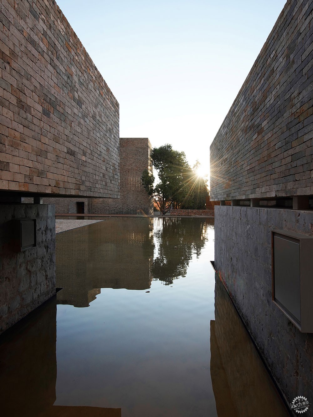

乡建八式 | 基于云南大知闲闲民宿改造的乡建实践第5张图片
▲夜景透视©杨文龙

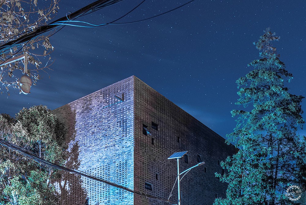

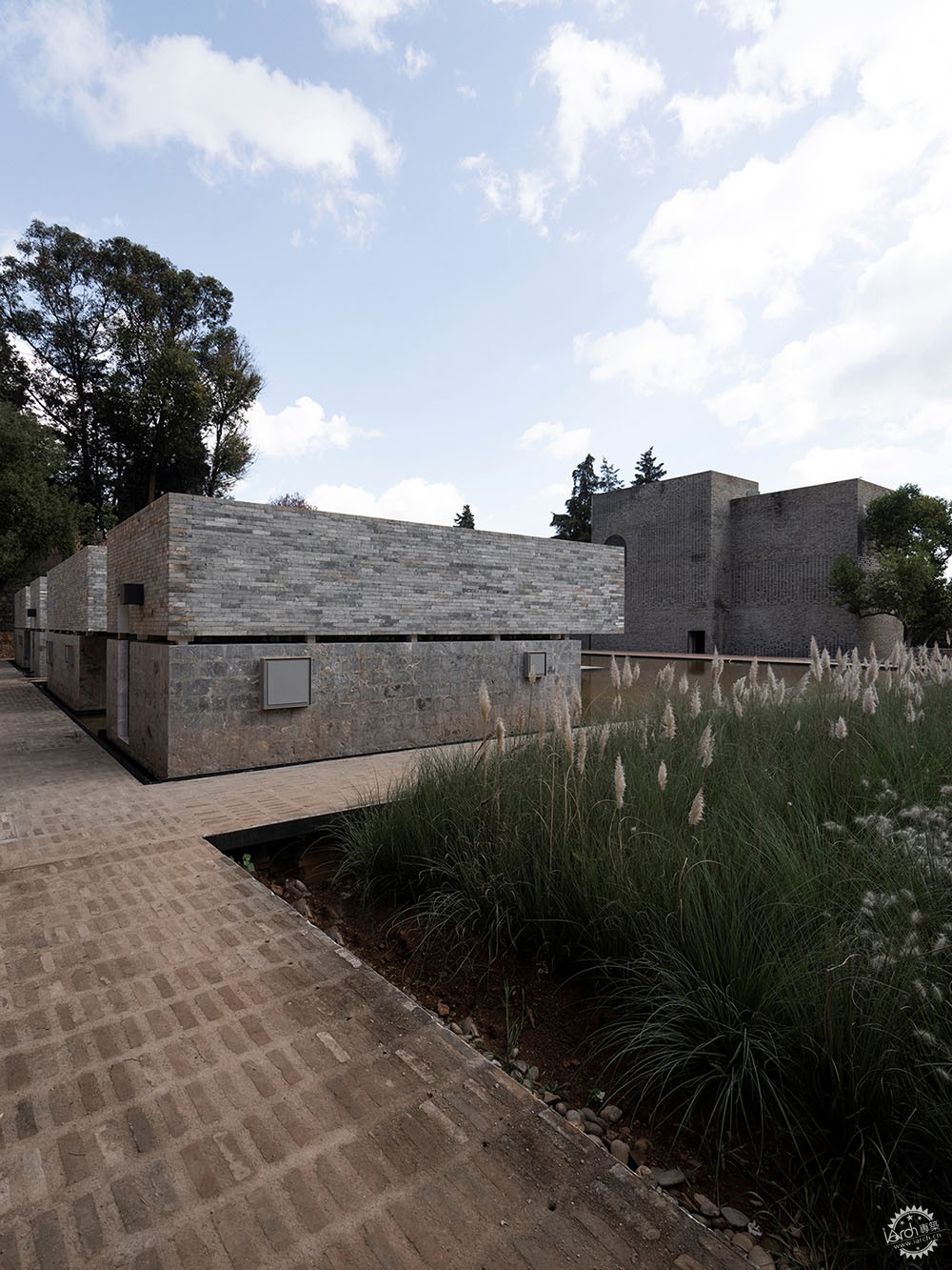

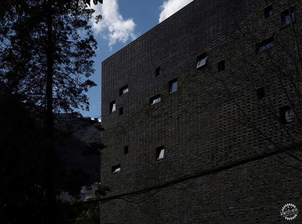

整个建筑西立面屏蔽西侧视线可及的山体坟墓群视角,不设一窗,无窗因此也呼应了朝内一二层建筑的尺度感。
The entire west façade of the building blocks the view of the mountain tombs that can be seen on the west side and the west side without a single window responses the scale of the first and second floor inside the building.

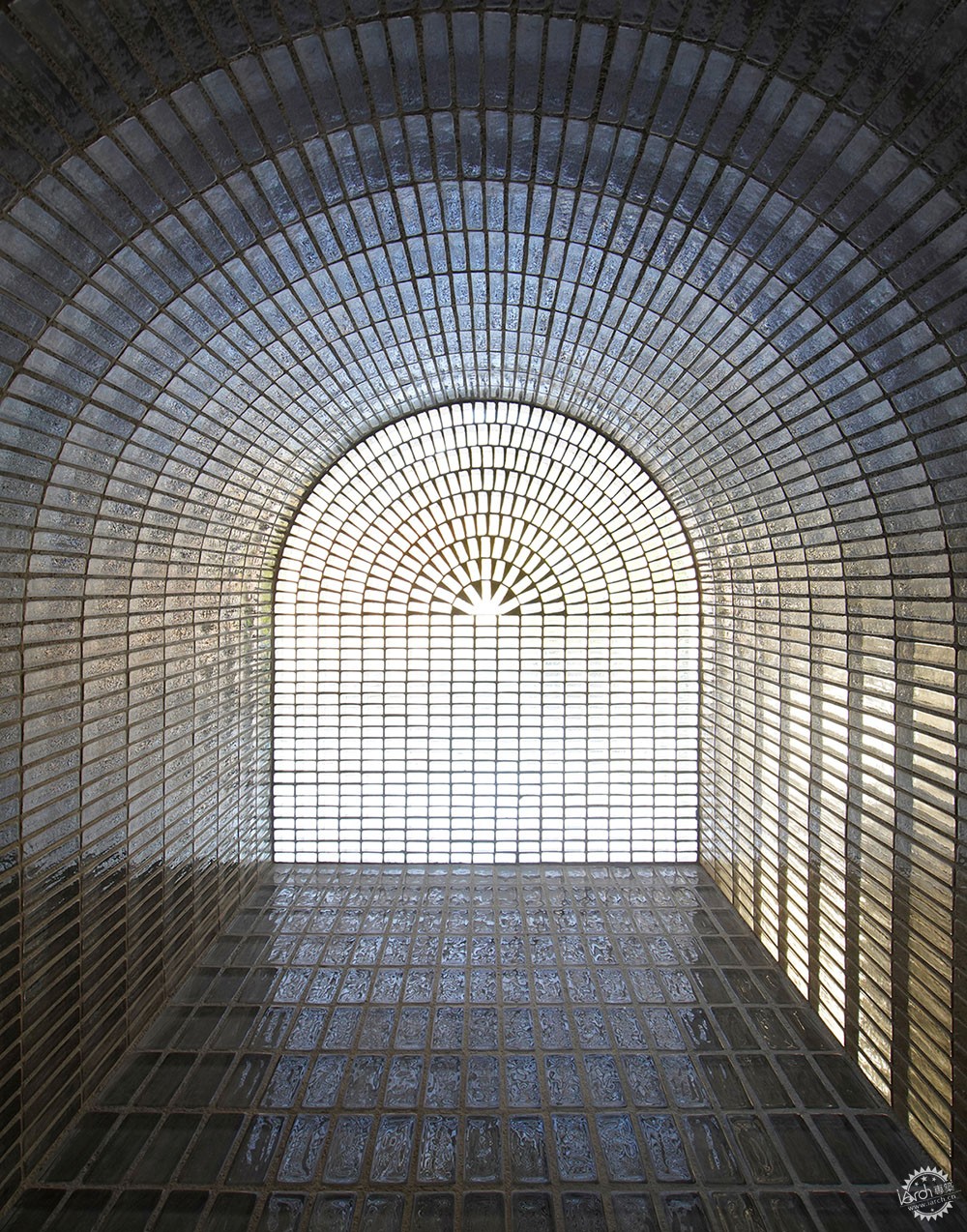

乡建八式 | 基于云南大知闲闲民宿改造的乡建实践第6张图片
▲西立面透视©阮晓舟

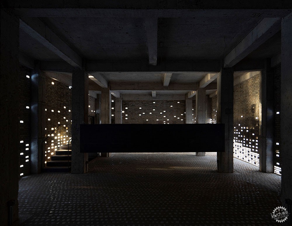

首层是餐厅功能,最靠近水面,微风吹动,动态的水面和树影可透过渐变布置的半透明玻璃砖反射到室内,与室内铺地的旧瓷片呼应,使室内餐厅呈现水边居所的静谧与活力。东西侧通过定制的砖尺寸可开启弹射窗,形成趣味通风系统。
The first floor is the restaurant, where is closest to the water surface.  When breeze blows, we can see the reflection of the moving waterand tree shadows inside the room through gradient arrangement of half-translucent glass bricks. The reflection responses to the old porcelain tiles on the floor, which presents the tranquility and vitality of a waterside residence. It forms an interesting ventilation system by ejection windows opened on the east and west sides through customized size of bricks.

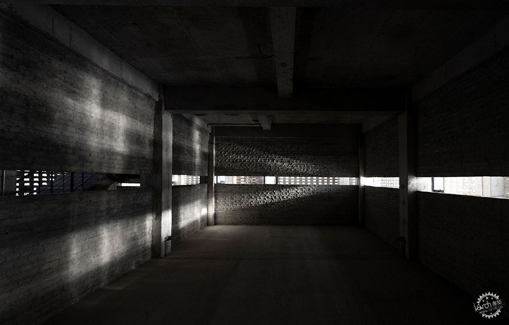

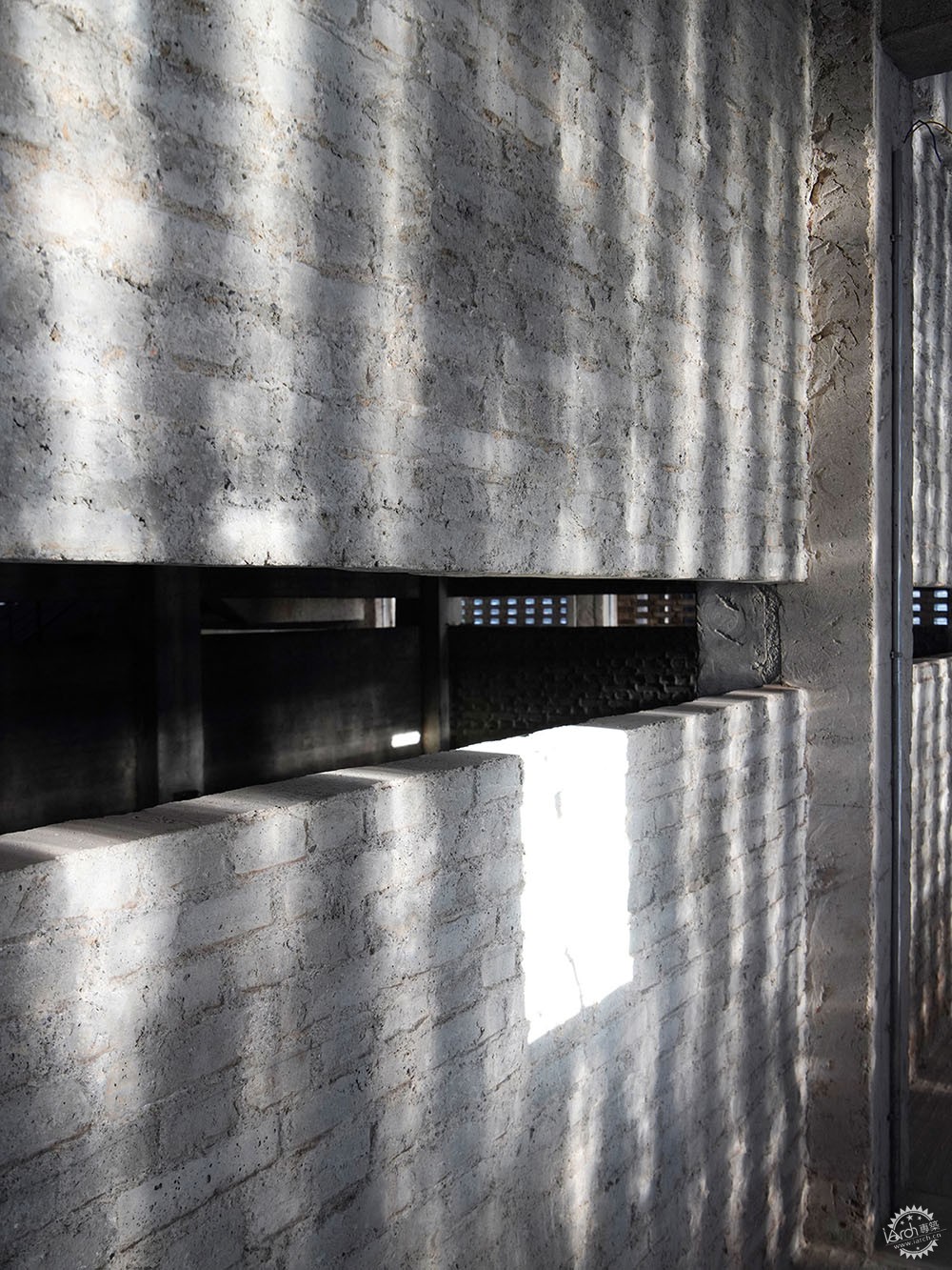

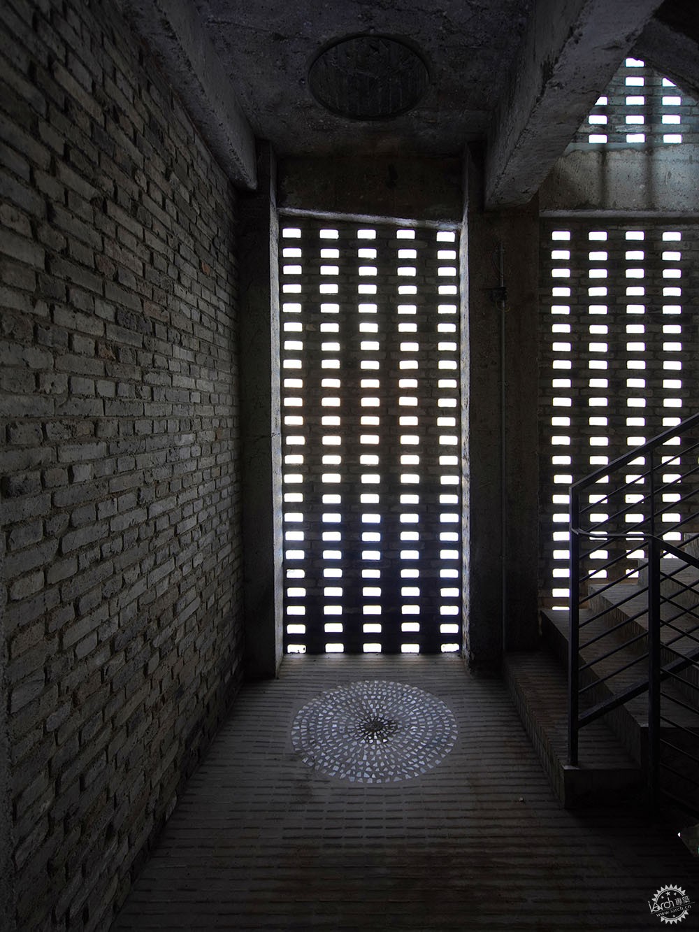

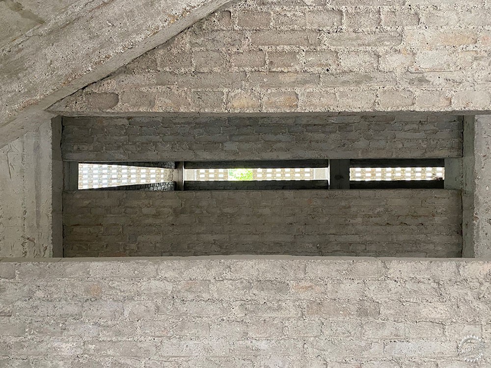

二层是多功能厅。由于乡村建筑的二层已经远离地面,和地面关系变弱,空间关系尝试向内拓展,在室内通过本地青砖模板浇筑工艺形成阁楼空间,满足外侧书吧内侧临时会议的复合功能。阁楼留一条240mm高的缝隙,经过外墙均匀玻璃砖折射的城市光影投到外侧走廊,又经过阁楼缝隙进行二次过滤,投射到阁楼内部。
There is a multi-functional hall in the second floor. Since the second floor of rural building is far away from the ground, it has weaker relation with the ground, we decided to expand spatial relationship inward.The attic space is formed indoors through template pouring technology of local blue bricks to meet the needs of a book bar outside and a conference room inside. A 240mm-high gap was left in the attic, we can see that urban light and shadow refracted by the uniform glass bricks on the outer wall are projected onto the outer corridor, then filtered through the attic gap and projected into the interior of the attic.
乡建八式 | 基于云南大知闲闲民宿改造的乡建实践第9张图片
▲二层内部大空间©杨文龙
乡建八式 | 基于云南大知闲闲民宿改造的乡建实践第10张图片
▲二层墙体过滤光斑©杨文龙
阁楼的缝隙,在多功能空间中产生了内外不同距离下的空间切割。建筑在这里成为时光机器,她尝试控制时间关系和空间关系。

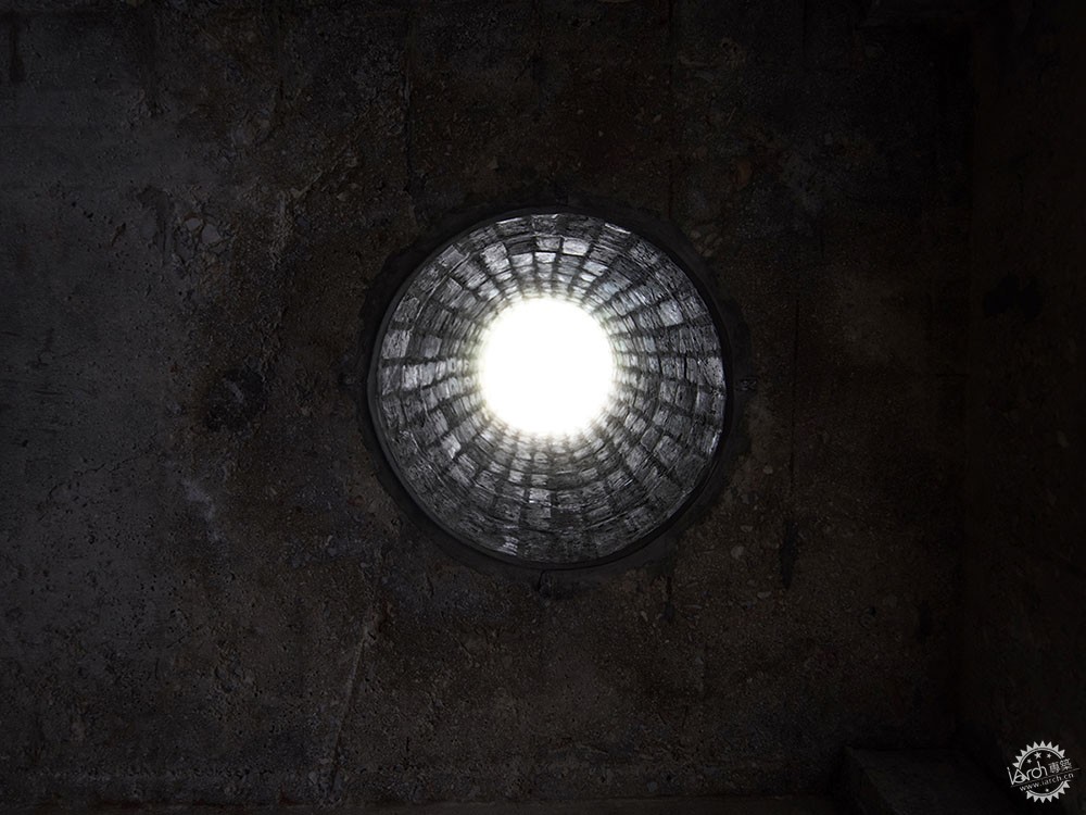

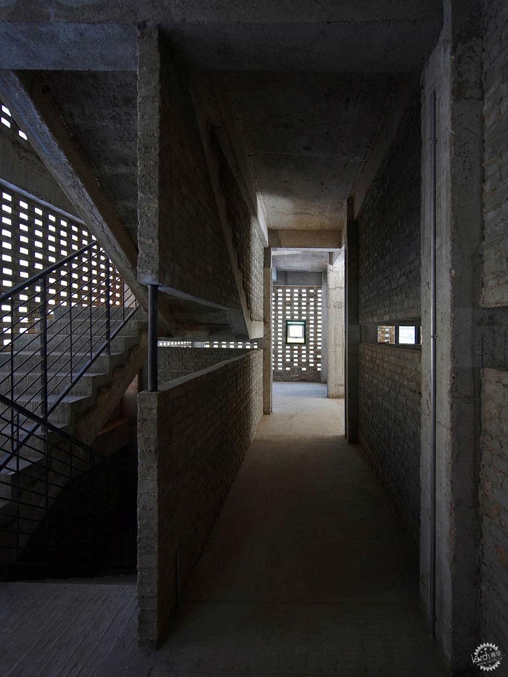

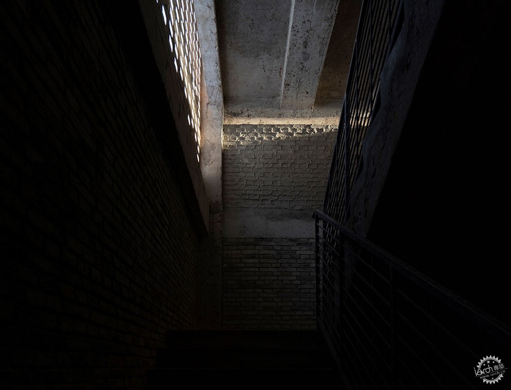

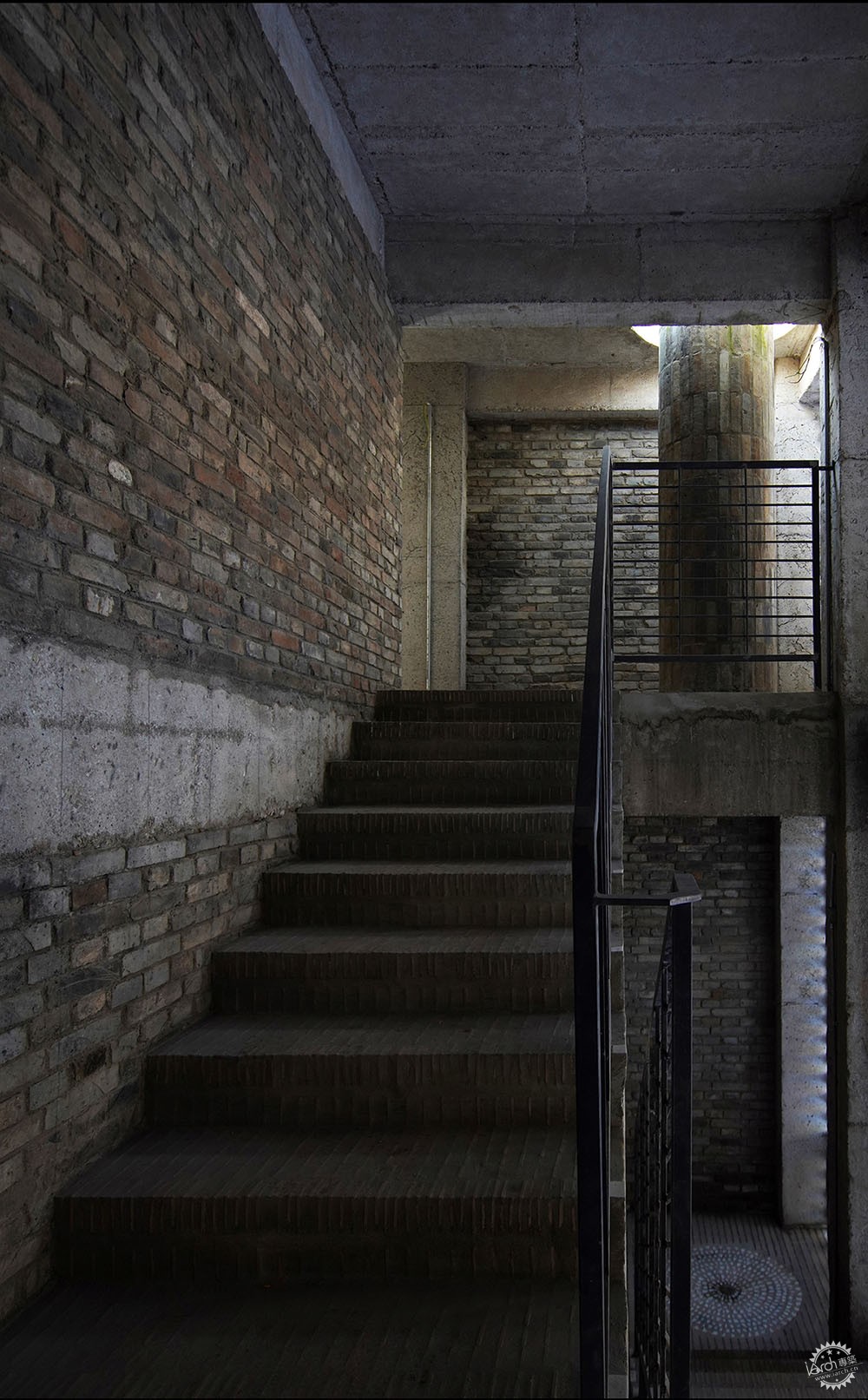

从三层到四层楼梯间休息平台的通风筒同时保证了通风和采光,并引导雨水的收集。
The gap in the attic creates spatial cuts at different distances inside and outside the multi-functional hall. The building becomes a time machine, trying to control the relationship between time and space.
The ventilatorsofstairwell rest platformfrom the third to fourth floors ensure ventilation and lighting at the same timeand guide the collection of rainwater.
乡建八式 | 基于云南大知闲闲民宿改造的乡建实践第11张图片
▲三层楼梯青砖通风筒©杨文龙
乡建八式 | 基于云南大知闲闲民宿改造的乡建实践第12张图片
▲三四层楼梯看青砖通风筒©杨文龙

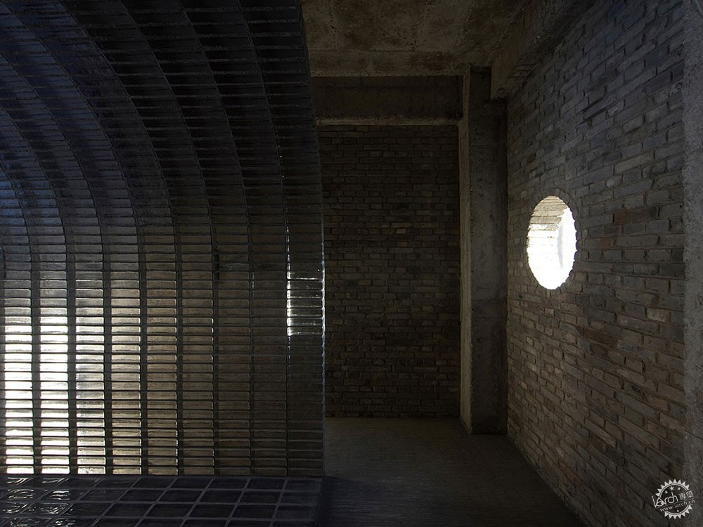

三层客房空间在静谧的过道尽端以玻璃砖拱构建半围合空间,把东侧朝阳点状光和西侧的夕阳引入室内,成为光的发生装置。光的场域创造了聚拢和神性。使用上形成了客房人群一到四人的冥想空间,茶室和私人教堂。
The guest room space on the third floor is semi-enclosed built with glass brick arches at the end of the quiet passageway. It becomes a light generating device by bringing in sunrise light on the east side and sunset light on the west side into the room. The field of light creates gathering and divinity, and it can be used as meditation place, tea room and private chapel for one to four people in the guest rooms.

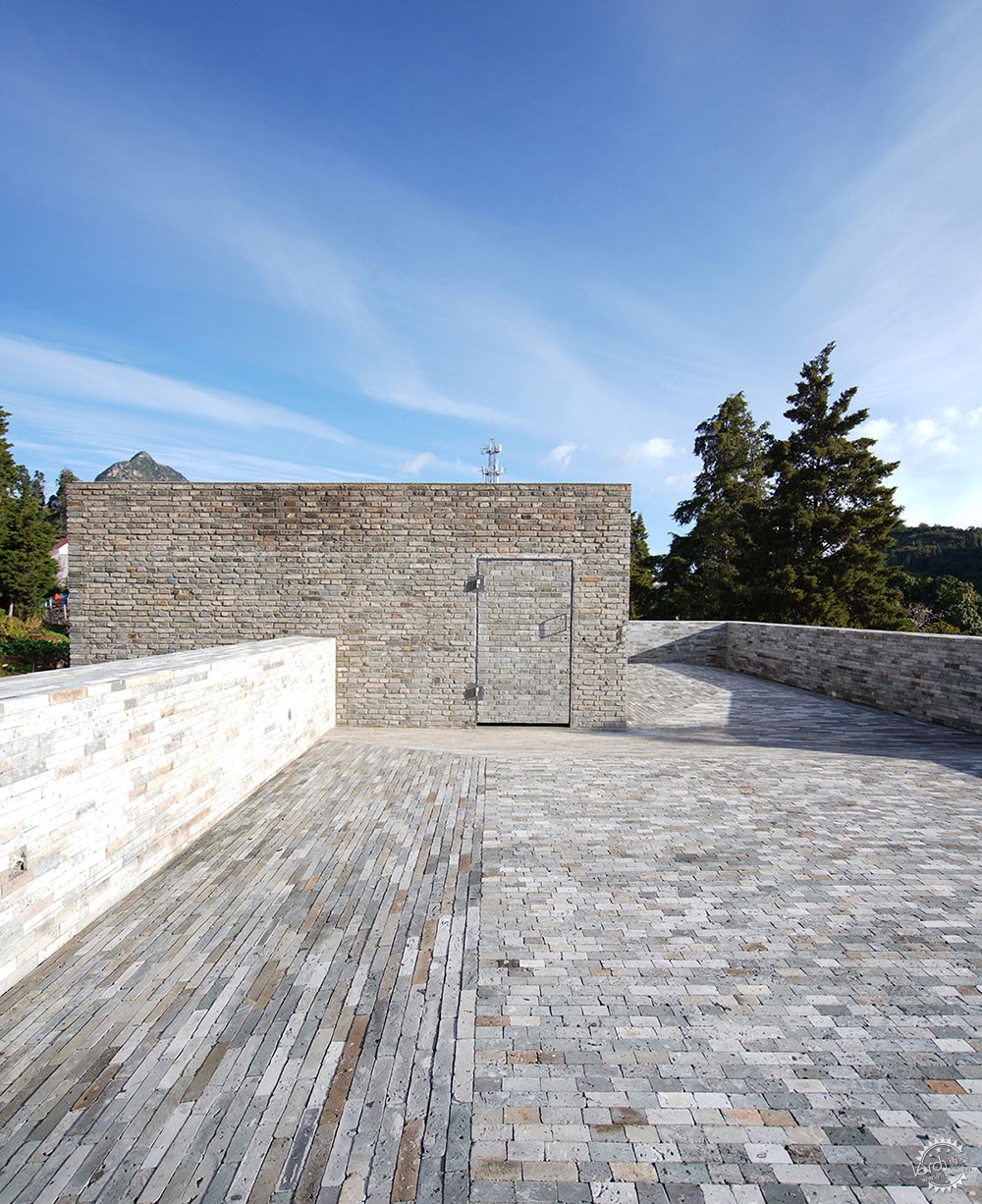

透过四层的通风筒光线,把人引导到上人屋顶户外的山形坡顶,晴天夜色,可三两人躺卧坡面,仰望苍穹,可行可望可居可游,归于自然。
The light from the ventilator on the fourth-floor guides to the mountain-shaped slope of the outdoor roof. A couple of guests can lie on the slope and look up at the sky when the weather is allowed.

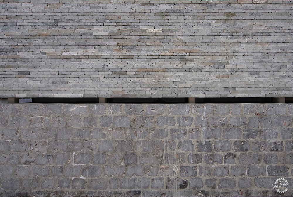

在地工艺的启发——砖混墙
以框架梁柱结构为基础,替换旧青砖为填充墙材料,二四墙外退楼板0.12米厚度,青砖成为建筑表皮。三层玻璃砖拱洞空间,砌筑构造延续了当地传统老砖窑拱的砌法,内部基层以木工板先围合拱形造型,以玻璃砖砌筑后,拆模可得,玻璃砖置换了砖的结构性。铺地采用建筑外墙玻璃的碎瓷片,根据防滑性区别,设计瓷片间距平铺或立铺,瓷片光泽与墙上玻璃砖形成光影叠加。
Inspiration of the local craftsmanship: Brick Walls
Based on the frame beam-column structure, old blue bricks were replaced as filling materials for walls.0.24m thick wallswere set back with a thickness of 0.12m. The façade is old blue bricks. The masonry structure of the three-story glass brick arch spacecontinues the local traditional practice of old brick kiln. The inner base layer was first enclosed in an arched shape with wood panels, thenbuilt with glass bricks.The glass bricks replaced the structure of the bricks after removing the formwork. The ground waspaved with broken porcelain tiles of the building glass façade. The tile spacing was designed to be tiled or vertically pavedaccording to the difference of slipping resistance. The luster of the tiles and the glass tiles on the wall form a superimposition of light and shadow.
乡建八式 | 基于云南大知闲闲民宿改造的乡建实践第17张图片
▲铺地细节©阮晓舟

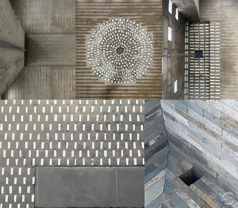

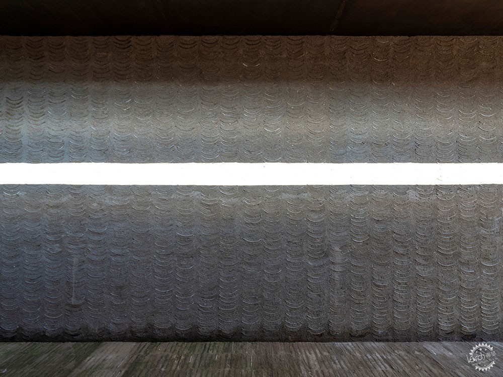

二层多功能厅阁楼空间用青砖作模浇筑混凝土板,由于上部吊挂结构,需一次成型,拆模后保留旧青砖粘结的不同色彩,整体呈现粗粝的质感。当地老匠人在浇筑建筑物时由于模板缺少,会采用水泥砖临时围模,为青砖作模提供了依据,呼应了青砖外墙和混凝土结构梁柱。以砖为模以钢筋混凝土为填充材料形成高强度墙体,这里简称砖混墙。
We usedblue brick as molds to cast concrete slabs in attic space of the multi-functional hall on the second floor. Due to the upper hanging structure, it needed to be formed at one time. After the mold was removed, the different colors of the old blue bricks were retained, and the overall texture was rough. The local old craftsmen used cement bricksfor temporary enclosureas they had not enough molds when pouring the building. It provides the basis for the blue brick formwork, responsive to the blue brick exterior wall and concrete structural beams and columns.A high-strength wall was formed by using brick as the mold and reinforced concrete as the filling material, which is referred to as brick-concrete wall here.
乡建八式 | 基于云南大知闲闲民宿改造的乡建实践第18张图片
▲二层过道看砖混墙©杨文龙
砖混墙在控制工艺上有三个难点,首先,砌筑需要一次成型,控制好砌筑砂浆的缝隙,并用含水泥量少的砂浆砌筑,可方便拆模。其次,需要控制拆模的时间,如时间太长,混凝土会完全粘结砖体,拆除会对墙体造成结构破坏。再次,需要分段拆模,分段砌筑,这样才能满足每段的拆模时间,同时也延续了老匠人用砖替模板做模的原因:可重复利用。如果以砖混墙建造建筑,区别于砖混建筑和剪力墙建筑。砖混墙建筑实际的受力构件是钢筋和混凝土,结构性等于剪力墙建筑并优于砖混建筑。砖混墙建筑可以成为剪力墙建筑加上青砖工艺的建构,是更具建筑表现的构造方式。而砖混墙建筑和砖混建筑的联系是都是用了砖和混凝土,但方法不同。
There were three difficulties in the process of manufacturing the brick-concrete wall. First, we needed form the masonry at one time and control well on the gap of the masonry mortar then used the mortar with less cement content for masonry, because it could facilitate the removal of the molds.Secondly, we had to control the time for removing the molds. If the time was too long, the concrete would completely bond with the brick body, and the removal would cause structural damage to the wall.Thirdly, we also had to dismantle the molds in sections and built it in sectionsso as to meet the demolding time of each.And it wasalso the reason why the old craftsmen used bricks to make the molds: recycling.If a building is built with brick concrete walls, it is different from brick concrete building and shear wall building. The actual stress components of brick concrete wall building are steel bars and concrete, and the structure is equal to shear wall building and better than brick concrete buildings. It is a more architectural way when the building is a shear wall one with construction of blue brick technology. And the similarity between brick-concrete wall building and brick-concrete building is that both bricks and concrete are used, but the methods are different.
乡建八式 | 基于云南大知闲闲民宿改造的乡建实践第19张图片
▲二层砖混墙特写©阮晓舟
建筑原型
建筑表皮旧青砖和玻璃砖的自然过渡,以及外立面较少的开窗,强调力量感的同时弱化了建筑的尺度感。如湖中独石,完全成为介于自然和建筑之间的过渡。以居住为功能业态,砖楼的居于石中回应了居住建筑原型洞穴。人类最初的居住场所,人类的原始洞穴仅仅具备遮风挡雨保温的简单功能。而本案人为设计了自然通风、采光、雨水收集系统,成为自然的外墙青苔以及外墙弱反射的自然特征,进一步挖掘“洞穴”中的自然潜能,呈现生活的诗意。人居于石中,亦或是人外造石?关于建筑的另一原型棚屋,约瑟夫 .里克沃特在《亚当之家》里提到:“对更新的渴望是永恒和不可逃避的。社会和知识的张力持续的存在就保证了这种渴望的不断发生。人们总是在季节变化和启蒙仪式中去寻找更新,很像理论家通过引用原始棚屋来改革堕落的习惯和实践。因此我相信,这种方式将继续给任何关心建筑的人提供学习模板。他们关心的建筑是一个原始棚屋,永远位于也许历史学家和考古学家触摸不到的地方,位于某个我必须称为伊甸园的地方。伊甸园既是一个承诺,也是一个记忆。”
Architectural prototype
It emphasizes the sense of strength while weakening the sense of scale of the building by the natural transition between old green bricks and glass bricks on the skin of the building, as well as the fewer window openings on the façade. Take the solitary stone in the lake for example, it completely becomes the transition between nature and architecture.As residence is the main function, stone houses in brick building responds to the residential building prototype, the cave. As the first settlement for human being, the original cave only has the simple function of shelter from the wind and rain and heat preservation.This project was artificially designed with natural ventilation, light and rainwater collection system.It exploresthe natural potential in the ‘cave’ and presents the poetry of life by the natural exterior moss and features of weak reflection on the exterior wall.  You are living in the stone or making the stone outside?About the other prototype of the building shack, Joseph Rykwert states in On Adam’s House in Paradise: ‘The desire for renewal is eternal and inescapable. The constant presence of social and intellectual tensions ensures that it will continue to occur. People have always gone in search of renewal in seasonal changes and rituals of enlightenment, much like the theorist who reforms degenerating habits and practices by citing primitive shacks. I therefore believe that this approach will continue to provide a template for learning for anyone who cares about architecture. The architecture they care about is a primitive shack, forever located beyond the touch of perhaps historians and archaeologists, in some place I must call the Eden. Eden is both a promise and a memory.’

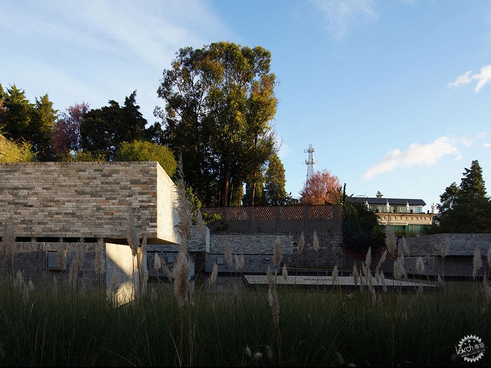

回应场地

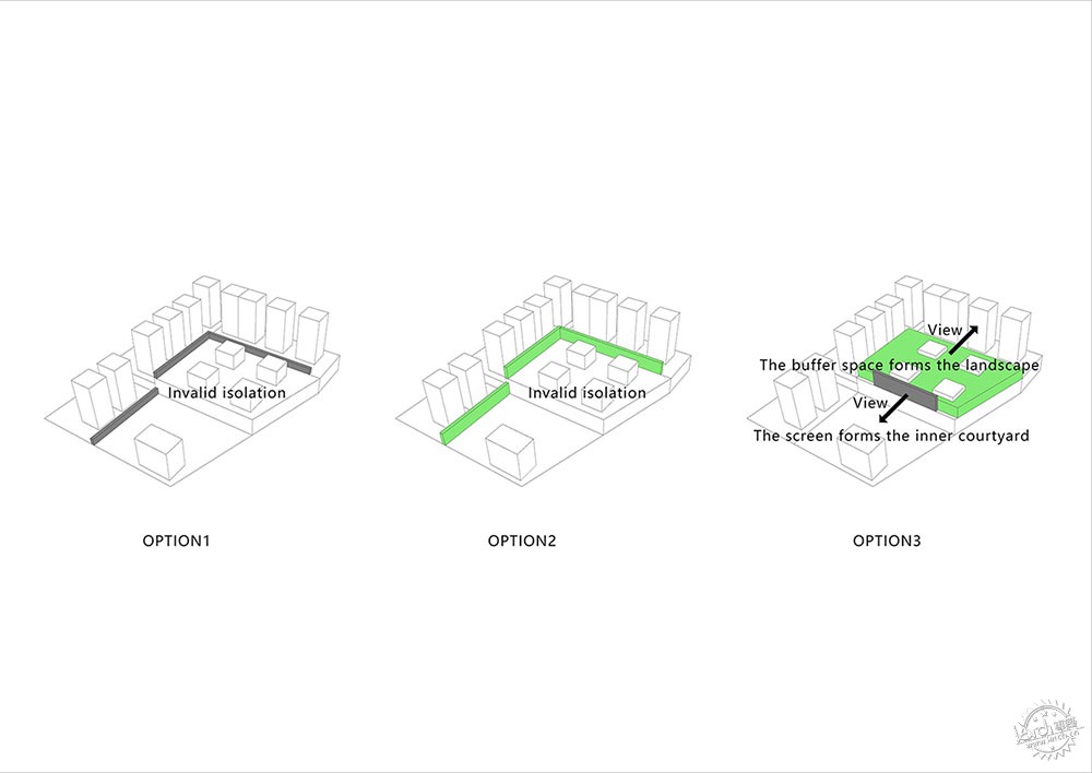

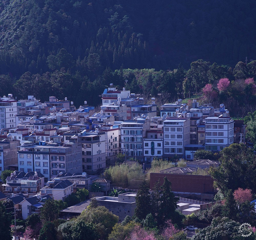

针对本项目地周边复杂的居住环境,分析梳理场地策略。原有场地有上下台地,高差6米,主楼和岗亭位于下台地,4栋别墅和附属房位于上台地。整个场地周边住宅高楼林立,通常在5-7层之间,且建造与改造杂乱无章,不利于作为项目背景呈现。策略一,在项目地周边建造围墙隔绝。但常规尺度围墙无法隔绝周边,且违背乡村规划要求,隔绝也不是和周边最友好的处理方式。策略二,以植被柔化。如6米高的竹林,但植被也形成了人为僵硬的围合区域,不能自然呈现与周边的关系,且尺度同样不足。我们选择策略三,从场地内部出发,转移视觉焦点,在上下台之间建造屏障围墙,形成场地内部的视觉焦点。
Respond to the site
We analyzed and sorted out the site strategy for the complicate residential environment around this project site. There were upper and lower platform with a height difference of 6 meters in the original site. The main building and the securityroomwere located on the lower terrace, and the four villas and attached house were on the upper one. The entire site was surrounded by residential high-rise buildings, usually between 5 to 7 stories without organized construction and renovation, which is definitely not ideal background for the project.Strategy A, a fence wall will be builtto isolate from outside around the project, but wall with ordinarysize cannot meet the demandsand it is against the requirements of rural planning. Isolation is not the best way to deal with the surroundings. Strategy B, vegetation such as 6-meter-high bamboo forest replacesthe fence wall, but it also forms an artificially rigid enclosed area that does not naturally present relationship with its surroundings and is inadequate in size as well.We chose strategy C to shift the visual focus from the interior of the site by building a barrier enclosure between the upper and lower terraces to create a visual focal point within the site.

屏障围墙的设置,导致上下院的关系进一步形成。下台空间开阔,上台种植大量竹林匹配别墅院落。上下台内部形成了院的体验反差关系,同时自然也把周边环境推到第三个层次,别墅院落的片状竹林缓和了与周边硬割裂的关系。
The setting of the barrier fence leads to the further relationship between upper and lower courtyard. The lower terrace is open to space and the upper one is planted with a large number of bamboo to match the villa courtyard. It makesdifferenceon the experience of the courtyard inside the upper and lower terrace, while nature pushes the surrounding environment to a third level, with slice of bamboo forest invilla courtyard improves the tough relationship with the surrounding area.

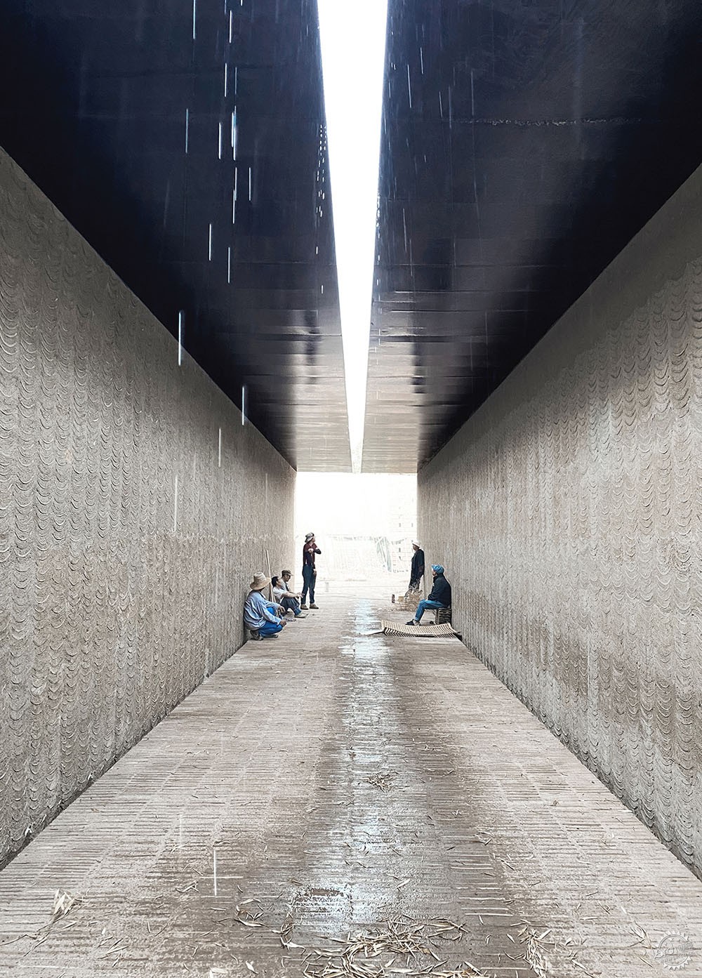

土屏建构

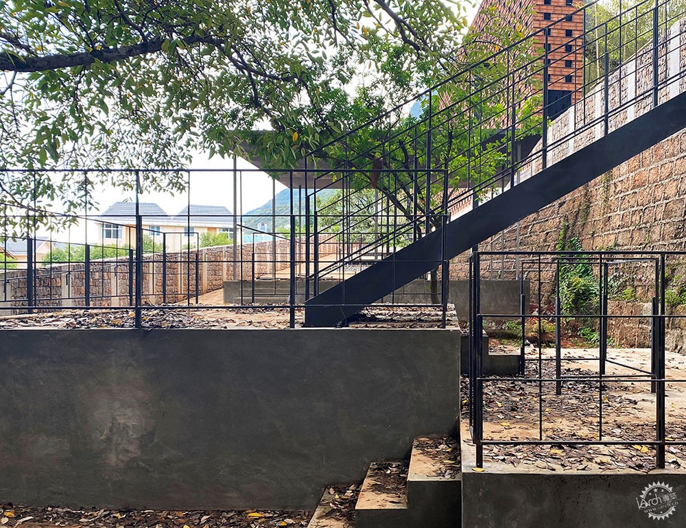

土屏高度7.1米,厚度1.4米。从使用流线上创造了内部可通行过道与上部可观景平台。上部平台通过钢楼梯衔接。整体采用HW200X200X8X12工字钢框架系统为主结构,单侧土基墙的实际厚度是0.1米,8X100钢板做为辅助框架,框住60厚的土基块。外侧通过拉锁锁住土基块,内侧挂网通过砂浆批荡,前后兜住土基块。根据采光和通风需要,可错位镂空一些土基位置。钢框架的使用避免了传统土基结构强度差和采光通透性不足的问题。针对防水性能不足的问题,适度增加了熟石灰配比,并使用渗透型防水剂进行面层保护。土屏是墙,因具有内部围合空间和良好通风采光特征也属于房。
the Tectonic of the Clay Screen
The ClayScreen is 7.1 meters high with thickness of 1.4 meters.It is composed by an interior passageway and an upper viewing platformconnected by a steel staircase. We used HW200X200X8X12 I-beam frame system as the main structure. The actual thickness of the single-sided clay wall is 0.1 meters and the 8x100 steel plate was used as auxiliary frame to fix the 60-thick clay block. The clay blocks were fixed by pulling the lock outside and mortar batchinginside.Somepositions of clay can be staggered and hollowed out according to requirements of lighting and ventilation. We used steel frames to avoid poor structural strength and lack of light permeability of traditional clay. We moderately increased the ratio of slaked limeand used penetrating waterproof agent for surface protection to deal with the problem of insufficient waterproofing.The ClayScreen is a wall, and it is also a house because of its internal enclosed space with good ventilation and lighting.

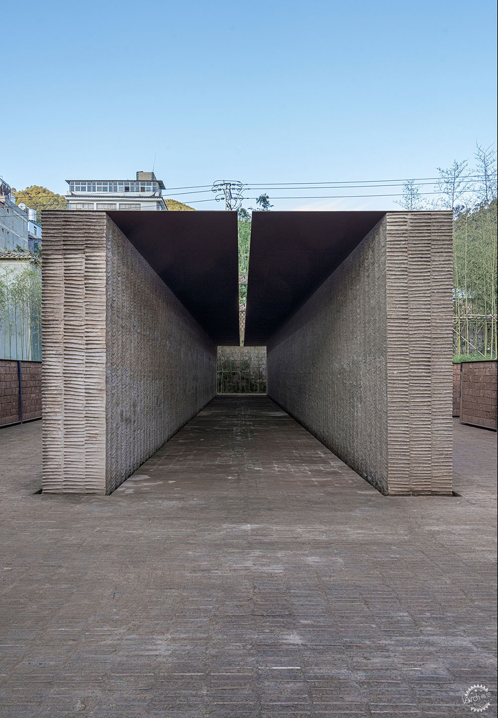

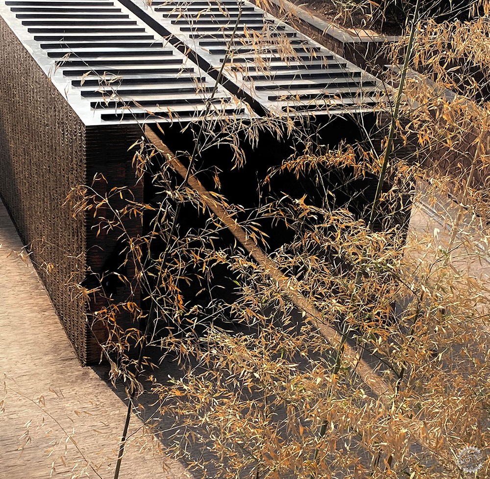

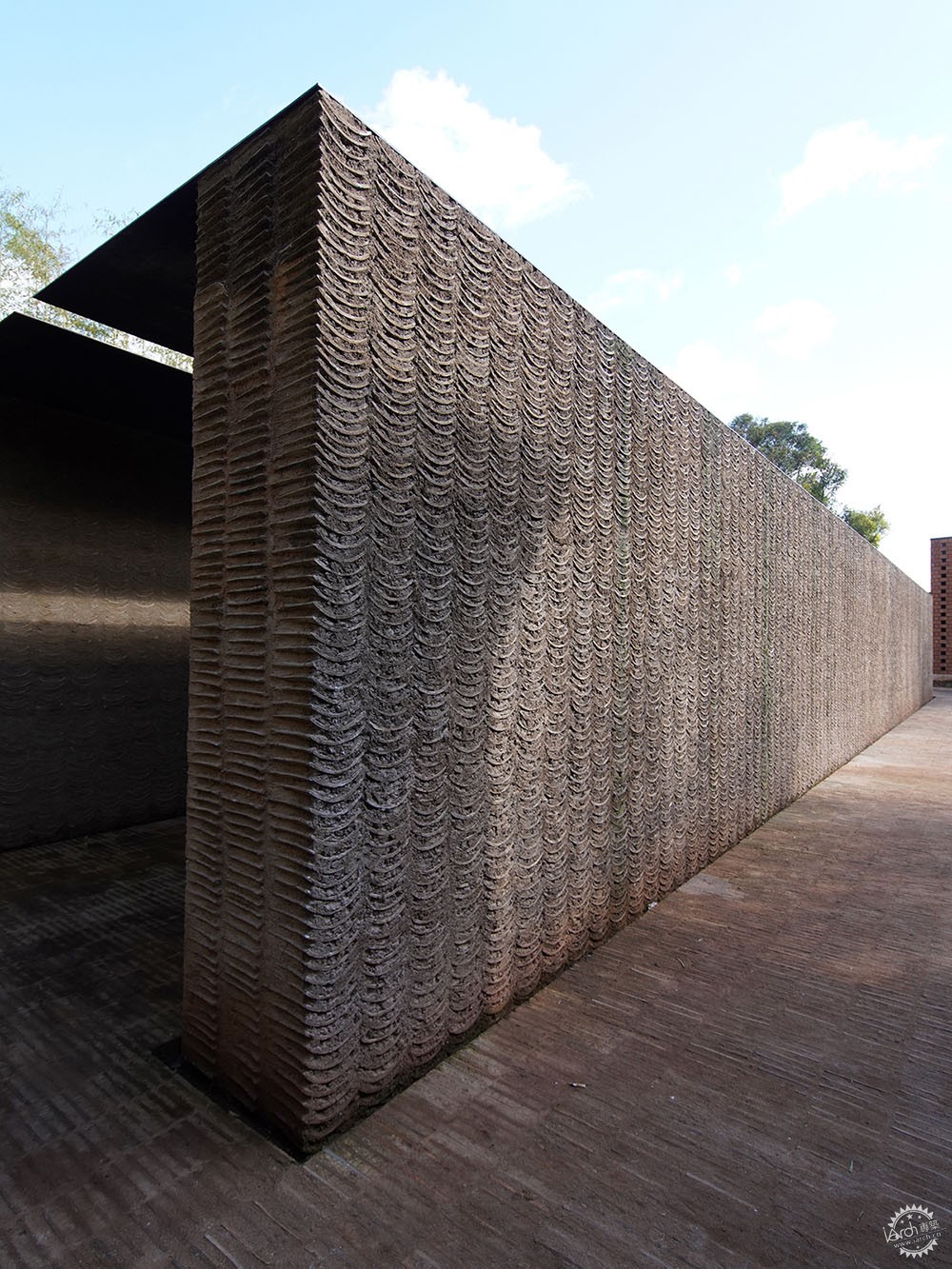

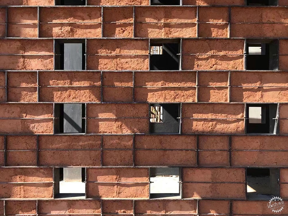

雨亭:社区共享
the Rain Pavilion, to Live in Community
生成
砖墙=砖+砂浆+结构柱
瓦墙=瓦+砂浆+结构柱
瓦墙+单侧钢板挑檐=瓦墙檐
两个对称的瓦墙檐=墙亭

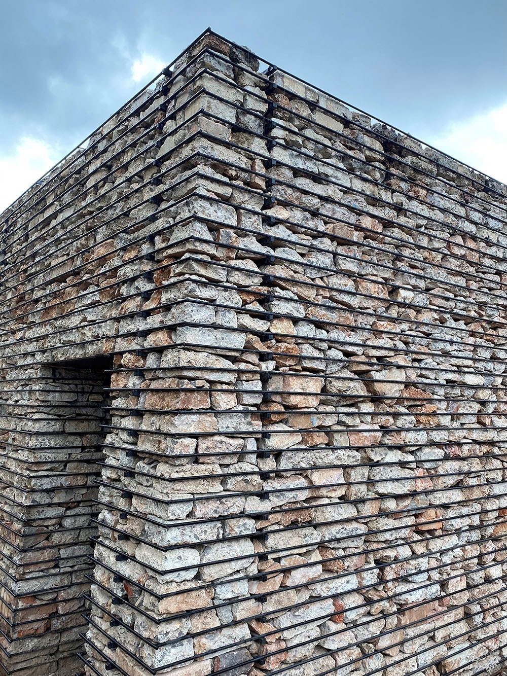

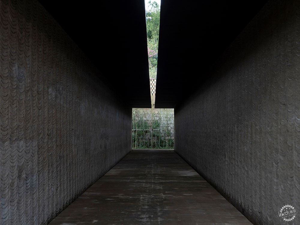

墙体厚度0.78米,高度3.5米,长度27米,厚度的依据是使用三块旧瓦的宽度。钢板挑檐长度1.6米。两侧的瓦墙檐在中间预留了0.24米的缝隙间距。把轻薄的屋檐忽略,墙亭是独立的墙,把瓦墙檐的缝隙忽略,墙亭是亭。
How to build the pavilion
Brick wall=bricks+ mortar +structural columns
Tile wall=tiles + mortar + structural columns
Tile Wall + single-sided steel eaves = Tile wall eaves
two symmetrical tiled wall eaves = Wall Pavilion
It is 0.78m of wall thickness, 3.5m of height and 27m of length. The thickness is based on the width of three old tiles.The length ofsteel eaveis 1.6m. The tile eaves on either side were pre-defined with a 0.24m gap in the middle. The wall pavilion is a freestanding wall if ignoring the thin eaves and is a pavilion if ignoring the gaps in the tile eaves.
乡建八式 | 基于云南大知闲闲民宿改造的乡建实践第33张图片
▲雨亭正透视©杨文龙
垒起来的瓦颠覆了瓦的性能,从排水作用转化为承重作用。由于瓦墙檐钢板的完全水平性,导致雨水排向两个方向进行,从缝隙排出和从外侧瓦方向排出。从外侧瓦排出,瓦仍然具有排水性,瓦没有忘记原来的习惯功能。
Tiles
The stacking tiles reverses the function of tiles, from drainage to weight-bearing.The completely horizontal nature of steel plates on tile wall eves causes rainwater to drain in two directions, through the gap and the outer tiles. The outer tiles are still for drainage which is the conventional function of tiles.
乡建八式 | 基于云南大知闲闲民宿改造的乡建实践第34张图片
▲雨亭内部空间透视©杨文龙
排水
屋面排水从两个方向排出,到了地面全部用墙体下四周的排水沟收集。这也导致雨天地面都在跑水,墙亭不具备雨天长时间停留的功能。雨天墙亭回归自然,墙亭又是雨亭。
Drainage
The roof drains in two directions and it is all collected by drains under the walls on the ground. This also causes the ground to drain a lot on rainy days, which makes the wall pavilion is not suitable for long stay. The wall pavilion returns to nature on rainy days and becomes a rain pavilion.
乡建八式 | 基于云南大知闲闲民宿改造的乡建实践第35张图片
▲雨亭雨天氛围©阮晓舟
空间内外属性
从人的体验出发,晴天的时候瓦屋檐侧围合的空间可遮阳,属于内部空间,无檐侧属于外部空间。雨天的时候,无檐侧仍然是外部空间,而有檐侧也变成了外部空间。但如果穿着拖鞋去瓦墙檐侧下踩水并感受屋檐下飘雨的气氛,那么有檐侧仍然是内部空间。对称的瓦墙檐,类似两栋传统房屋外侧的檐口。按照这个逻辑缺少房屋的无檐侧是居住空间,是人的记忆能感受到的内向空间,而瓦墙檐是外部空间。空间内外属性在体验中不停变换。
the Space inside and outside
From the point of view by guests, the space enclosed by the tile eaves roof is an internal space because it provides shade on sunny dayswhile it is an external space by the side without eaves.When it rains, the external space remains, while the side with tile eaves changes to an external space.But if you wear slippers to tread water under side with tile eaves and feel the atmosphere of the rain falling under the eaves, you can also regard the space is an internal one. Symmetrical tiled eaves, similar to the cornices on the outside of two traditional houses.
According to this logic, the side without eaves in house is the living spacein memory and the side with tile eaves is external space. It can be changed to each other.
乡建八式 | 基于云南大知闲闲民宿改造的乡建实践第36张图片
▲雨亭侧透视©阮晓舟
功能&结构
雨亭的功能具有开放性,可以作为展览、聚会、讲座、交流的使用空间,对社区开放,唤醒过去的记忆。
墙体采用混凝土框架结构,顶部钢板挑出1.6米,靠后侧暗藏于墙体直径为16毫米的钢筋拉坠,屋面板的调平利用相距250毫米、截面为10×60毫米的筋板调节。
Functions & Structure
The functional openness of the Rain Pavilion allows it to be used as a space for exhibitions, gatherings, lectures and talk. It is open to the community and can evoke the memory of the past.
The wall is of concrete frame construction with a 1.6 m overhanging steel plate at the top and a 16 mm diameter reinforcing steel bar drop concealed in the back side of the wall. We used steel plates with 250mm pitch and 60 x 10mm wide/high to level the roof panels.

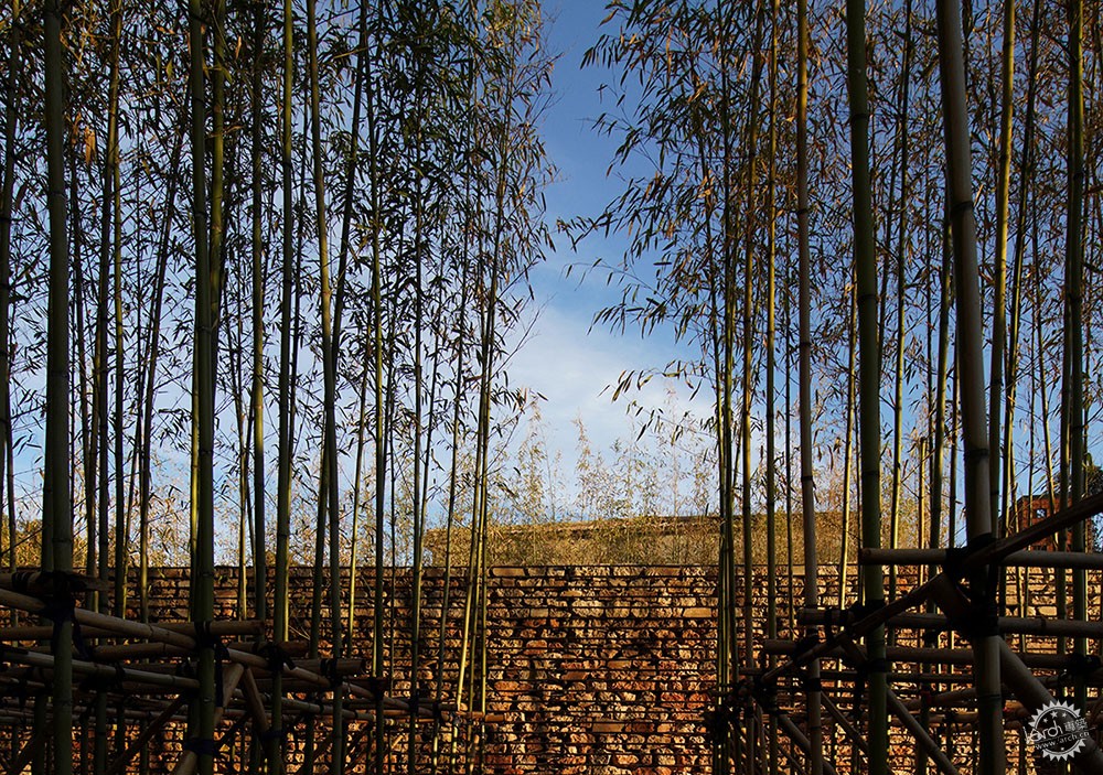

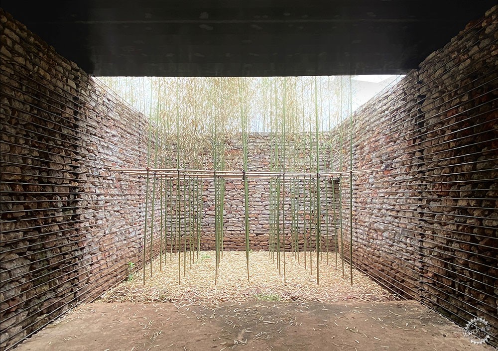

幽篁里:自然建造
the Bamboo Pavilion,to Live in Nature
生成
首先,我们开挖混凝土地面,利用混凝土废料在特定的位置围出如院落般的废料墙。其次,在围出的废料墙内增加两个钢板遮阳顶以提供休憩。最后,在废料墙和遮阳顶以外的所有空间均匀种植竹林。没有特定的路,人进入的方式是自由的。没有限制竹林的范围,竹林是自由的。
First, the concrete floor was excavated and the concrete waste was used to create a courtyard-like waste wall at a specific location. Secondly, two steel plate shade roofs were added inside the enclosed waste wall to provide rest. Finally, a bamboo forest was planted evenly in all the space outside the waste wall and the shade roof. There is no specific path and people can enter in free way. There is no restriction on the extent of the bamboo forest; the bamboo forest is free.

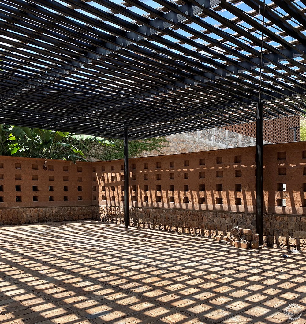

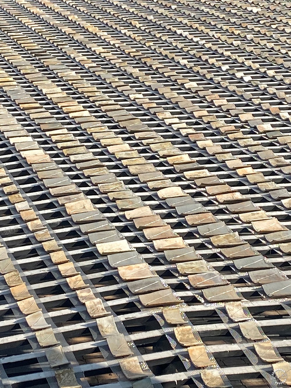

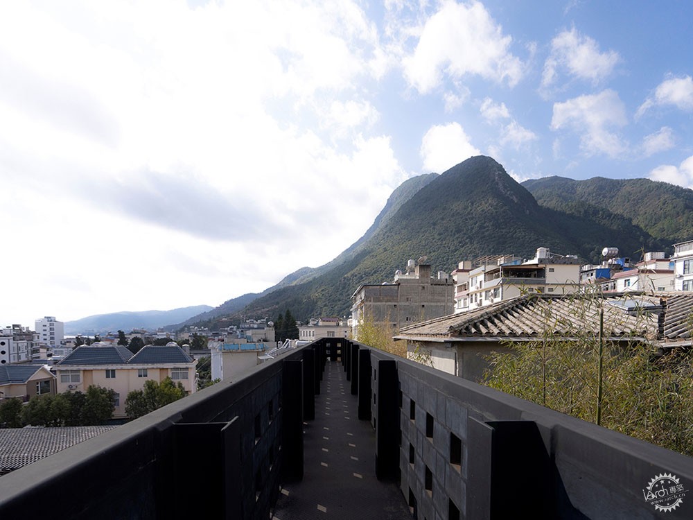

瓦亭:当代乡土
the Tile Pavilion, toLive in modern countryside
场地需求

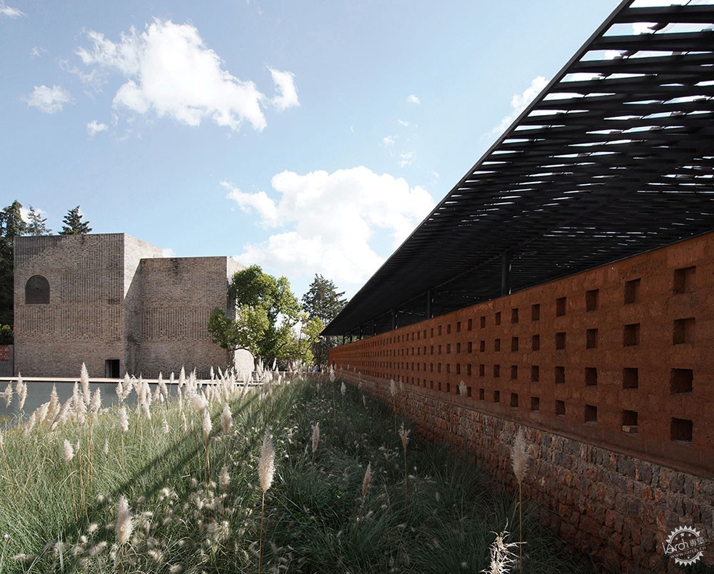

瓦亭的建造希望为停车场提供一个遮阳顶棚。
Site Requirements
The tile pavilion was built to provide a shade roof for parking lots.
乡建八式 | 基于云南大知闲闲民宿改造的乡建实践第43张图片
▲外侧透视©阮晓舟

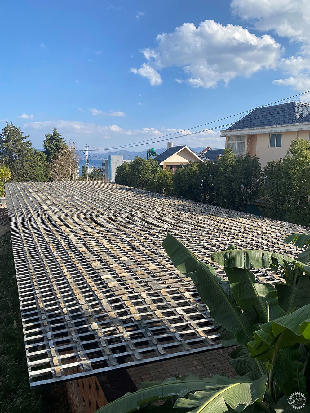

出于规划考虑,不能具有实体顶,屋顶装饰面需要镂空处理,只能作为构筑物廊架使用。
There was no physical roof out ofplanning consideration. The decorative surface of the roof needed to be hollowed out and could only be used as porch of the structure.
乡建八式 | 基于云南大知闲闲民宿改造的乡建实践第44张图片
▲内侧透视©阮晓舟
乡建八式 | 基于云南大知闲闲民宿改造的乡建实践第45张图片
▲下部绑瓦特写©阮晓舟
高技&乡土

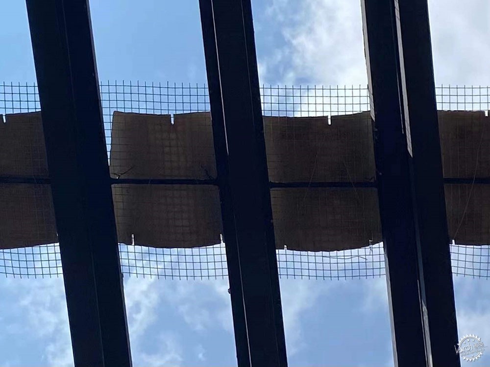

选用构件极其轻薄的钢架系统,施工建造具备相当大的难度,需要由专业的施工队伍完成。但瓦的绑扎完全采用本地工人的手工艺完成,且需要在施工现场和工人讨论最高效的施工方法。这也促成了高技与乡土从施工工艺上分时段结合施工的方法,且有效的适配了乡土材料工艺的当代性。
Advanced Technology and Local Craftsmanship
A professional construction team was essential due to the difficulty of construction of the steel frame system with extremely thin and light components. However, local workers were also necessary because the tile tying was done entirely by hand and they need to be on site to discuss the most efficient method of construction.This leads to a combined method of advanced technology and local craftin different process, which effectively adapts to the contemporary nature of the rural material process.

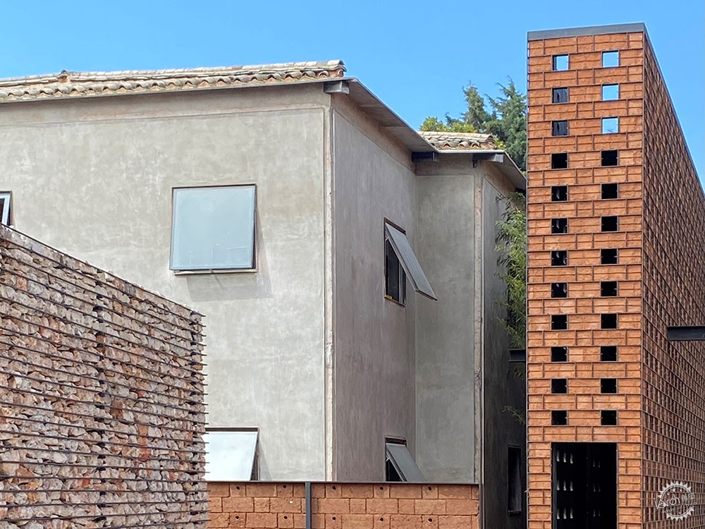

改造策略—原墙
四栋二层老别墅原始是不中不洋的折中主义房屋,建筑内外墙体的改造尝试微改造的可能性,这里称为原墙。
Renovation Strategy of the original walls
The four old two-story villas were originally eclectic houses that didn’t belong to Chinese style nor western style. and tried micro-renovationfor internal and external walls of the building which we called the original walls.
乡建八式 | 基于云南大知闲闲民宿改造的乡建实践第52张图片
▲别墅透视©阮晓舟

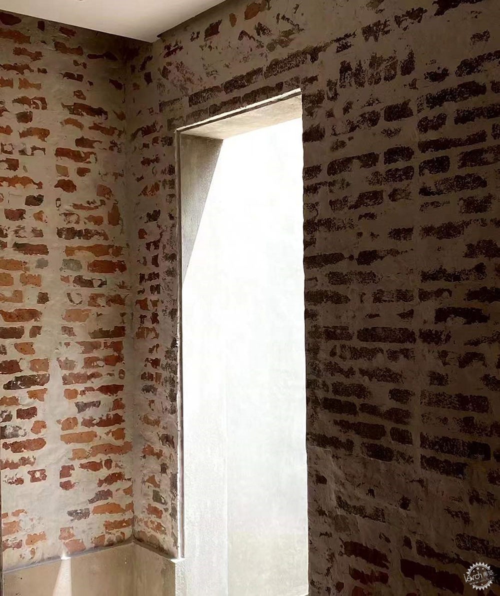

原墙的辩证
原墙的前提是本地的气候适宜,无需内外保温层设置。在建筑室内, 原墙的基础是建筑室内原建筑施工后去掉粉刷层的红砖墙体,属于老墙。利用胶泥填充和表面打磨可以增加老墙的结构强度并提升面层亲人质感。原墙加入了新的元素胶泥,本质上又是新墙,原墙在室内是时间性的辩证,又代表在改造过程中对建筑真实性的表达。
the dialectic of the original walls
The premise of the original walls is that the local weather is so good that no internal or external insulation is required. Inside the building, the foundation of original wallsisthe red brick walls that were removed from the stucco layer after original building construction. We used mastic filling and surface sanding to increase the structural strength of old walls and enhance the texture of the top layer.The original wallswere added with mastic, a new element, essentially becoming new walls. The original wallsare dialectic for time description inside the building, and represents an expression of architectural authenticity in renovation.
乡建八式 | 基于云南大知闲闲民宿改造的乡建实践第53张图片
▲内墙透视©阮晓舟
建筑外墙原始为小瓷片,小瓷片与建筑风貌不匹配。我们剥离了瓷片,选择采用批砂浆收光的形式,在砂浆内外做两层防水,可有效保障实用性。砂浆盖住柱子一半,预留一半,可以保证防水层在柱砖衔接处的有效覆盖,让雨水无法渗透进室内。其视觉感即像装饰又像结构柱,又感觉两者都不是。新做收光的砂浆呈现原始工艺质感,而露一半的老柱是原始材料,两者和谐共处。原墙在这里再一次模糊了新旧关系,构造上呈现装饰和结构的辩证。
The building façadewas originally small porcelain tiles. As these small porcelain tiles did not match the architectural style, we stripped all of them and used batch mortar to close the light. We did two layers of waterproofinginside and outside the mortar, which can effectively guarantee the practicality. We used mortar cover half of the column to ensure effective coverage of the waterproof layer in the column brick articulation, so that rainwater cannot penetrate into rooms.We see the columns as decorative and structural ones, but feel that neither at the same time. The new half of mortar cover presents the original craftsmanship and we can feel the harmony of coexistence of it with old halfof original material.The original walls here once again make it unclear between old and new, and they present dialectic of decoration and structure in construction.
乡建八式 | 基于云南大知闲闲民宿改造的乡建实践第54张图片
▲外墙细部构造©阮晓舟

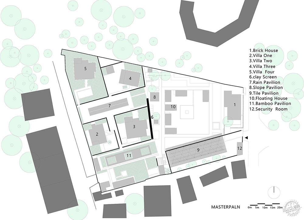

乡建八式 | 基于云南大知闲闲民宿改造的乡建实践第55张图片
▲总平面图©阮晓舟设计工作室
