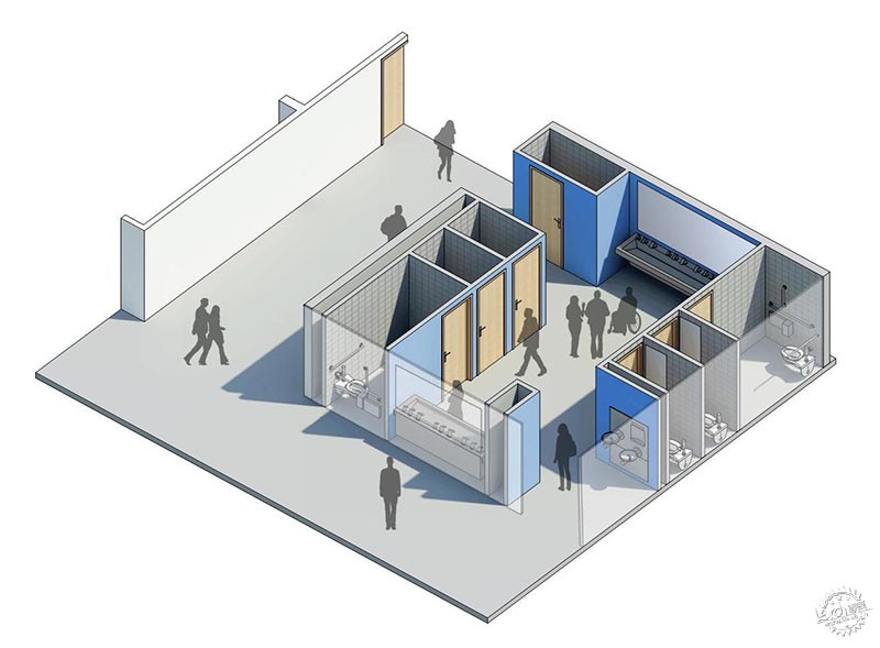

Mahlum为波特兰公立校区所设计的卫生间方案/Mahlum’s design solution for Grant High School in the Portland Public School District. Image courtesy of Mahlum
这就是波特兰公立学区的格兰特高中所表现出来的创新的精神会显的如此不凡的原因。
在2013年,该校已经公开有10位学生是变性人。为了帮助这些因为缺乏安全感而可能退学的学生,学校的管理者分配了四间学生浴室和两间员工卫生间给这些学生使用,每一个房间都配置有厕所、水槽以及镜子,从而对他们的性别表达出包容和理解。
这些卫生间很快受到了格兰特高中所有学生的欢迎,无论是变性学生还是正常的学生,他们都乐于使用这些能够提供私密性的封闭设施。
随着学校在20世纪20年代大规模的整修,该校区负责人意识到了为所有学生(约1700名)提供合理的厕所设施的必要性。
建筑公司Mahlum为格兰特高中所做的设计是将有封闭门的个人卫生间围绕一个中心空间进行布置,从而取代现有的“gang-style”卫生间,并且这些卫生间的门都开向公共空间,与此同时,在该空间里布置了洗手盆以及自动饮水器。并且不会再安装小便池。
两个入口和出口消除了学生内心的封闭感,让学生进入卫生间后具有安全性和私密性。
现在只需要一个简单的图案来代表卫生间,而不是用大家普遍使用的“男性”(裤子的图案),或者是“女性”(裙子的图案),抑或是两种标志共同使用来区分卫生间不同性别的使用者,现在的卫生间面向所有使用者开放。
格兰特高中整个学校的整改将于2019年完成,届时,它将会成为第一个在该地区,同时也是少数几个在全国拥有百分之百包容性卫生间的学校。
Which is why the initiative shown by Grant High School in the Portland Public School District has been so extraordinary.
In 2013, the school had 10 students who openly identified as transgender. To help combat the real possibility that they would drop out due to a perceived lack of safety, administrators designated four student bathrooms and two staff bathrooms—each individual rooms with a toilet, sink and mirror—as gender-inclusive.
The bathrooms were immediately popular with all students at Grant HS, transgender or not, who enjoyed the privacy afforded by these enclosed facilities.
With a major renovation of the 1920s-era school on the horizon, the District realized that providing equitable toilet facilities for all 1700 students would be essential.
Architecture firm Mahlum’s design solution for Grant HS centered around replacing all existing "gang-style" bathrooms with individual toilet rooms with full doors opening to a shared space for wash basins and drinking fountains. Urinals will not be installed.
Two entrance and exit points eliminate the feeling of going into a "dead-end" room, increasing safety and security.
Signed with a simple pictorial representation of a toilet, not the ubiquitous "his" (pants), "hers" (skirt), or "their" (both), the toilet room is open for use by all.
When the renovation is complete in 2019, Grant HS will become the first in the District—and one of the few in the nation—to house one hundred percent inclusive bathrooms.

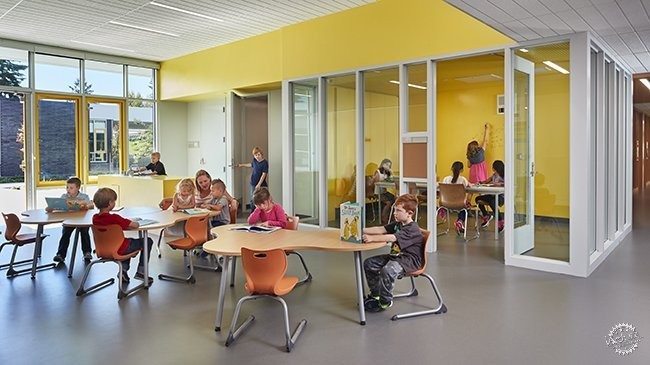

在墨瑟岛学区的新诺斯伍德小学中,同样的建筑团队一样放弃了“gang style”的卫生间布置形式,取而代之的是在各个楼层许多地方设置了个人卫生间。
这样的设计方案增加了卫生间使用的灵活性,从而减少了人们从别处到卫生间所花费的时间。
由于该校区力图保证将所有卫生间都面向所有学生开放使用,因此解决的办法是最大限度地提高卫生间的共享性,这对于刚刚在学习适应社会习俗并热衷于同其他同龄人相处的年轻学生来说相当有帮助。
高等教育机构也许更加能够容易实施这种共享型卫生间设计,因为这些卫生间的使用者更加年长、性格差异更大,并且都具有开放的思想。
For the new Northwood Elementary School in the Mercer Island School District, the same architectural team also abandoned gang style bathrooms, instead placing individual toilet rooms in many places on each floor.
This solution boosts program flexibility and reduces time lost to toilet transitions.
Since the District intends to keep the bathrooms unlocked and available to all students, the solution maximizes restroom equity, which is especially helpful for young students just learning to navigate social customs and keen to fit in with their peers.
