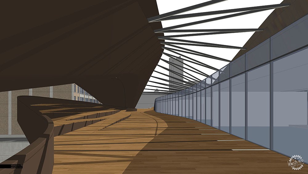

1. Sketchup Model
The Sketchup model is unchanged from the daytime rendering. The sun even remained in the same location.

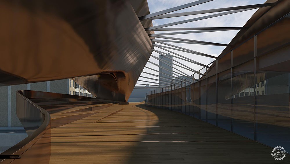

2. V-Ray Base Rendering
Above is the original V-Ray base rendering used in daytime rendering. Instead of spending time Photoshopping out the shadow lines, I rerendered with softer shadows seen below.
为了呈现柔和的阴影效果,我通过V-Ray编辑了太阳的选项。其他模型以及灯光设置都保持不变。
In order to get the soft shadow, I changed one setting which was increasing the size of the sun in the V-Ray option editor. Everything else remains unchanged in the model and light settings.
