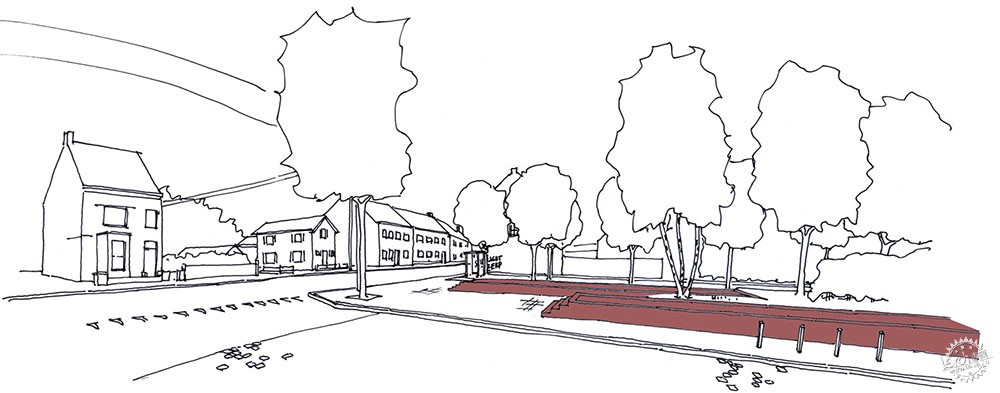

开放广场
打开整个空间的视觉关系至关重要。为此,站台上的现有树木经过砍伐。设计师希望从广场上的开放植物为出发点,从而形成变革性的姿态,广场中央部分没有灌木,周边的灌木树冠松散,从而引导人们进入开阔的景观区。广场焕然一新,每一个穿越和绕行的人现在都会注意到它,设计师将公共汽车站放置在广场的一侧,并从空间中心清除额外的物体和交通标志,将开放性表现出来。广场上还种了两棵大郁金香树,形成广场的“门户”,这将打开Helkijn Straat到田野之间的开阔景观。
Opening the Square
The most important spatial gesture is opening the visual relationship across the whole width of the place. For this the existing trees on the dam are thinned out. The aim is to generate a transformative gesture that spans from the openness of single trees on the square at Helkijnstraat, via a loose tree canopy with no undergrowth in the central part to a denser vegetative volume that “leads” into the open landscape. The square will have a new presence. Everyone crossing and bypassing will now notice passing over or by a square. The opening of the square is reinforced by placing the bus stand on the side of the square and generally clearing extra objects and traffic signs out of the centre of the space. Two large tulip trees are planted in the square. As a pair they will form a “gate” onto the square, and a gate from Helkijn Straat into the open landscape of the fields.

新平台
广场中央是一对长宽各不相同的“平台”,它就如同催化剂一样,以雕塑的姿态重新激活这座旧车站广场,这些“平台”用砖头包围,就像一对相邻的建筑,设计师以这种方式和姿态表达了对火车站和平台的抽象形式。广场上相互延伸的平台似乎在诉说着这里原有的火车站历史,强调了广场的背景信息。这种形式为Helkijn straat旁边的城市广场之间创造了一个过渡性的空间表达,同时形成了更加开阔的景观视野。而这两座平台也成为了公共空间中的社会功能元素,其高度为55厘米,可以用作座椅或舞台。两个平台之间的空间便是很好的聚会场所,因此也省去了广场上的城市小品。树林树冠下也设置了许多座椅,在这个介于广场和开阔景观之间的地带,野玫瑰等开花灌木让其成为一座阴凉的公园。在这里,骑行车、读书人等都可以放松休闲。
New platforms
The central, almost sculptural gesture to give the redesign of old Station Square catalysing moment for its possible reactivation, is a pair of “platforms” of different width and length. These volumes are fully clad in bricks, like the adjacent houses, and in this way create an abstract reminder of the train station and platforms in one gesture. Set on the square and extending into the adjacent dam, the two re-enacted „platforms“ enhance the context with a narrative of the former train station. The forms create a transitional, directional gesture between the more urban square next to Helkijnstraat and the departure of the tree covered dam into the open landscape. The platforms can become socially functional elements in the public space. Set at a height of 55 cm they can be used as seat and/or a stage. The space between them has invites to meet and come together. No further site furniture is necessary on the square. More seating is offered under the tree canopy in the grove on the dam. In this zone between square and open landscape flowering shrubs such as wild roses could make for a shady park-like place. Here a few benches offer relaxed seating for a rest on a bicycle tour, for reading a book, or a friendly chat.
