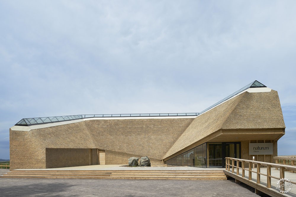

乍一看,Dorte Mandrup对Wadden海洋中心的设计似乎是在模拟风景。其低矮的高度,水平的线条,尤其是材料,使其成为与当地自然完美和谐的现代建筑。但实际上这座建筑与环境的联系也包含了该地区的建筑遗产,更具体地说,它使用了在附近收割和干燥的稻草覆盖建筑。这是一种极其传统和历史性的建筑技术,但很少被用于当代建筑。在这篇文章中,我们将介绍这种天然材料的历史,特点和一些使用实例。
At first glance, Dorte Mandrup's design for the Wadden Sea Center seems to mimic the landscape. Its low height, its horizontal lines and, above all, its materiality make it a modern building in perfect harmony with the local nature. But its connection also encompasses the built heritage of the region, more specifically because of its covering with straw, harvested and dried close to the land. This is an extremely traditional and historic building technique, but which is rarely attributed to contemporary buildings. In this article we will rescue some of the history of this natural material, its constructive characteristics and some examples of use.

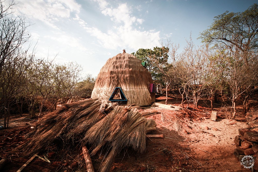

茅草屋顶是一种传统的方法,包括使用干燥的纤维,如稻草、芦苇、棕榈树和其他天然纤维来创造一个屋顶覆盖物。这些纤维被分组并以一定的方式交织在一起,形成一个表面,通过连续的重叠变得防水,老鼠和害虫几乎无法穿透。屋顶自下而上安装,顶部是最注重维护的地方,因为它是水渗入的薄弱点。坡度较陡的屋顶会使水流得更快,防止潜在的渗透问题。但这并不意味着这种材料限制了设计师的创造力,因为它是灵活的,所以可以很容易地实现有机的形状,就像Porky Hefer Design设计的The Nest一样,在这个项目中,茅草材料包裹着屋顶和大部分墙壁。
Researching the history of the use of thatched roofing is quite challenging. As it is a natural and biodegradable material, there are very few traces of its use in old constructions, unlike stone structures or even rudimentary cements, for example. However, researchers point out that the thatched structures date from the time when humans stopped being nomads and dedicated themselves to agriculture. There are indications of their use in the Aztec empires and in the first buildings of what we now call Europe, as well as research on its use in Europe, the UK and Mexico, among many others.
Thatched roofing is a traditional method that involves using dry fibers such as straw, reeds, palm trees and other natural fibers to create a roof covering. These are grouped and interwoven with a certain tension to form a surface, which through successive overlaps becomes impermeable and almost impenetrable to rodents and pests. The roof is mounted from the bottom up and the top is where more care must be taken and more maintenance must be done, as it is a weak point for water infiltration. Roofs with a steeper slope will make the water run faster, preventing potential infiltration problems. But this does not mean that the material restricts the designers' creativity. Because it is flexible, organic shapes can be easily achieved, as is the case with The Nest, by Porky Hefer Design, in which the material surrounds the roofs and most of the walls.
