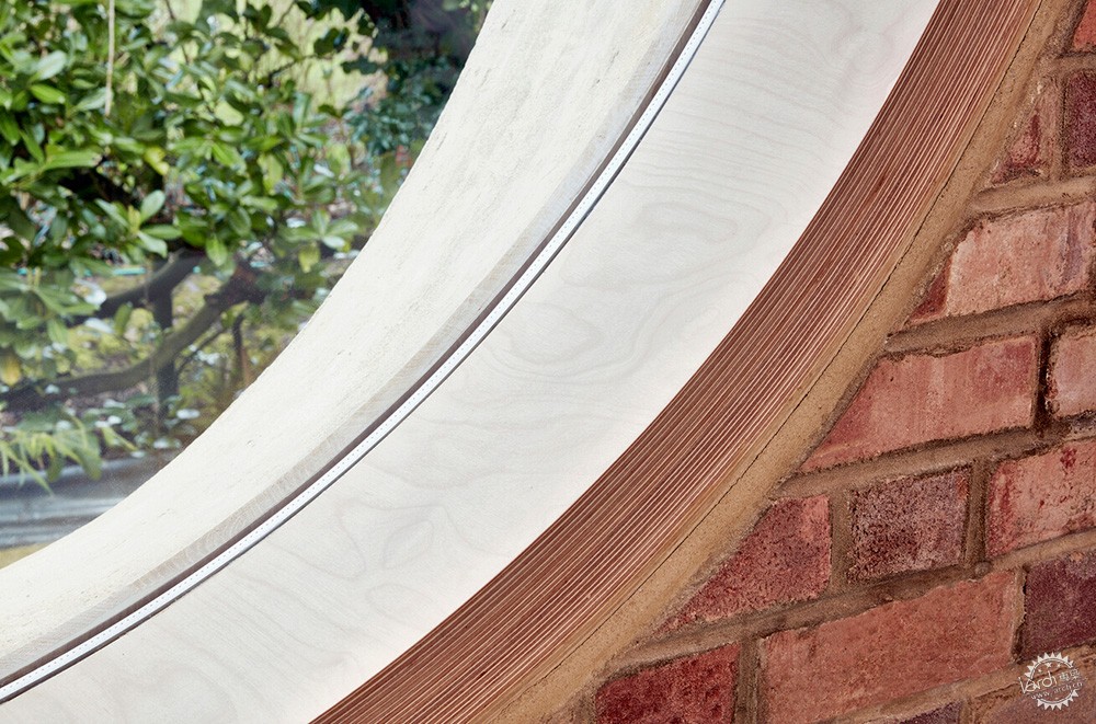

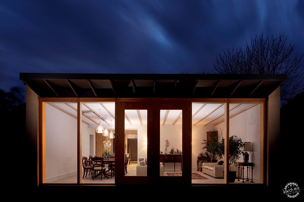

建筑布局由视线组织,使用者能感受到从入口到逐渐沉浸于内部花园景观的这样一个过程。
新的构建元素从现存的乡村别墅开始设置,并在两个轴线上分别形成一套系统:一个是朝向入口的庭院;另一个则面向花园。穿梭于两个部分,人们自然会被园中的景致所吸引。
Set up around a series of sightlines, the building explores a transition from the moment of arrival to a gradual immersion in the garden setting.
The new-build element is set off an existing cottage and formed of two frames with distinct axes: one orientated to the entrance courtyard, the second to the garden. Walking between them gradually draws the eye into the garden setting.

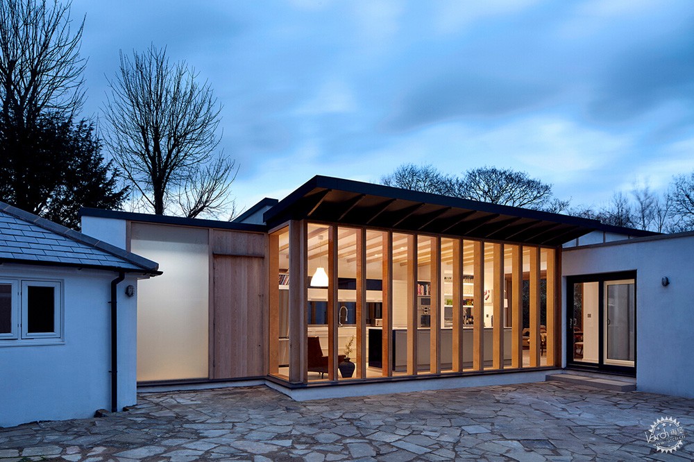

因为采用异地施工技术,TDO有机会将成本限制在100美元/平方英尺。单层结构都运用了参数化设计并在承包商的工作室中加工完成,采用了标准板材尺寸和方便运输的部件。因此,这个建筑大部分都是预制的,最后在场地进行组装。
Working with off-site construction TDO saw an opportunity to meet the 100 / sq ft budget. The single storey structure was designed within the parameters of the contractor workshop tools and working methods, using standard sheet sizes and easily transportable elements. The building was largely pre-fabricated and fixed together on site。

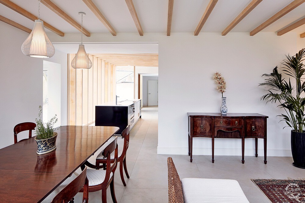

TDO的理念在于使用经济的,来源广泛的建筑材料,并做出让人珍视的细部。实践过程中,他们广泛尝试了桦木板这种材料;而该建筑的用户也希望建筑师能在这个项目中继续桦木板的研究。这就形成了建筑材料的原则。
TDO’s intention was to use economic, widely available materials and detail them in a precious manner. As a practice they have experimented widely with birch faced ply, which the client was excited to explore further. This formed the principle building material.

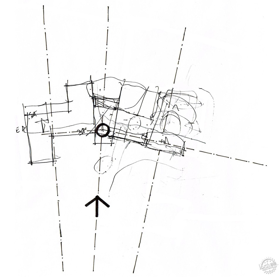

Draw/绘图

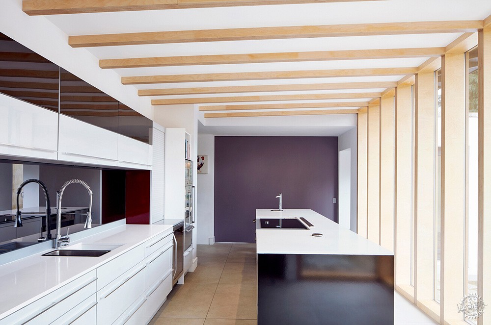

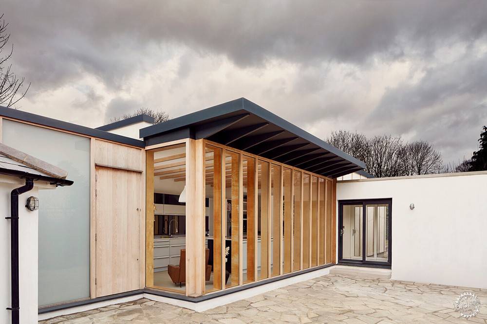

东南部厨房的立面采用宽度较宽的框架,以起到遮阳和遮挡外部视线的作用。暴露的结构网架对齐立面框架,并挑出墙面形成一个遮阳篷。
Window frames on the south-eastern kitchen elevation are formed as deep fins to protect from southern sun and overlooking. The exposed structural grid aligns with the frames and oversails the external wall to form a shading canopy.

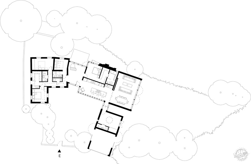

Type Plan/平面图

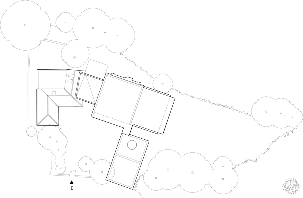

Roof Plan/屋顶平面图
