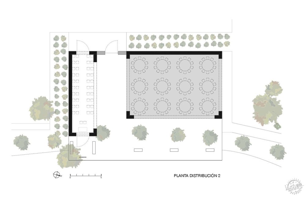

我们在设计时注重空间与人直接或间接的灵活性联系,因此在其平面设计上,我们调整了十字架的位置,通过开门和关门来改变其布局形式。
Noting the direct and flexible relationship of these spaces with people, we come to the design of its plan and the changing location of the cross and the opening or closing of doors that modifies its distribution.

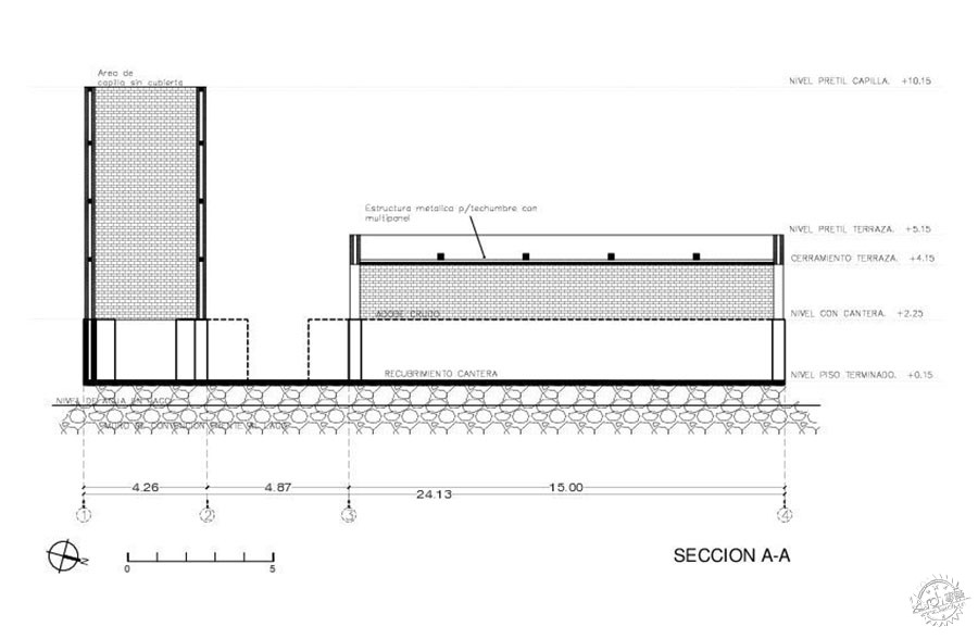

砖块是该项目中主要使用的材料,多亏了钢材的应用和其特殊结构特性,砖块才能战胜该地特殊的自然气候成为建筑的主角,比如建筑中13米宽的开口,在此还需支撑8米高的双层砖墙。
Adobe is the primary material of the project, and thanks to the application of steel and its structural properties, that the adobe can be a protagonist in applications that challenge the natural properties of its components, an example being the opening of 13 meters in length, where a double adobe wall stands 8 meters high.

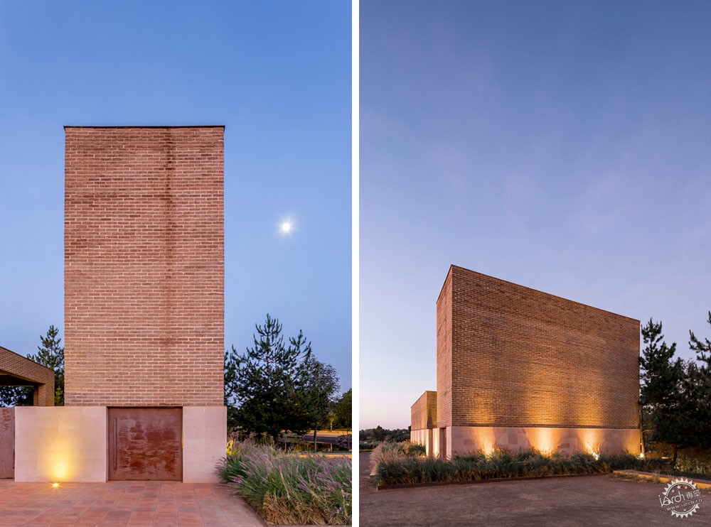

双层砖墙给人以震撼的感觉,一方面由于其材料传达出的独特品质,另一方面建筑通过开口的流动性和对场地的延展性也传达出轻盈之感。
The double walls are perceived with an extraordinary quality on the one hand by the great character that conveys its material, and the other with extraordinary lightness by the fluidity of the openings and continuity with the landscape.

Centinela教堂/ estudio ALA第14张图片
Plan/平面图
Centinela教堂/ estudio ALA第15张图片
Plan/平面图

Centinela教堂/ estudio ALA第21张图片
Detail细节
