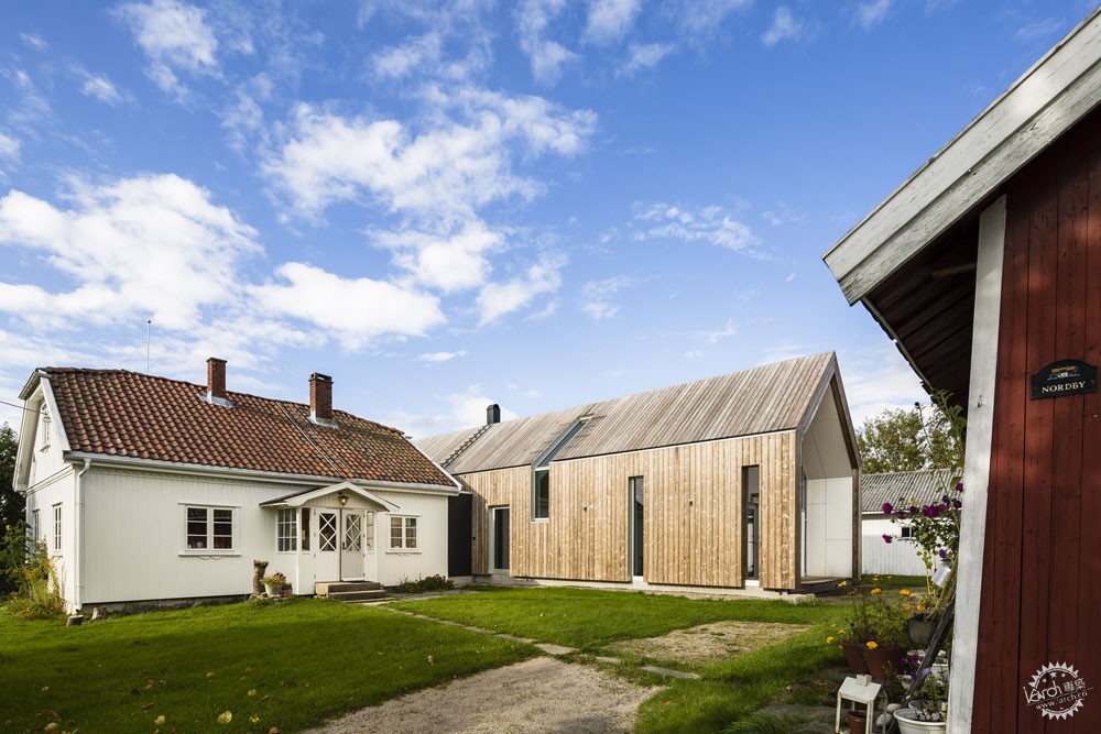

建筑灵感来自19世纪的设计,建筑师将一幢位于格罗马河(挪威最长的河流)东岸的一座破旧农舍改造成21世纪的现代建筑。
Lersch家庭2000年左右买了这间破旧的农舍,希望保留这座建于1900年代早期的农场的历史痕迹。他们试图置入新的体量来扩展现有的住宅并重建原来的农舍。部分建筑需要被拆除,其他部分需受到重点保护。
Inspired by the original 19th Century design, a rundown farmhouse on the east side of the River Glomma - Norway’s longest and largest river - has been brought into the 21st Century by LINK architects.
The Lersch family bought the dilapidated farmhouse shortly after the millennium and were keen to preserve the historic building, intending to restore one of the last historic farmsteads, prominent in the area in the early 1900s. They sought to develop an annex to extend the existing residential property and redevelop the original triangular-roofed farmhouse building. Some sections needed to be demolished, other parts required significant attention.
