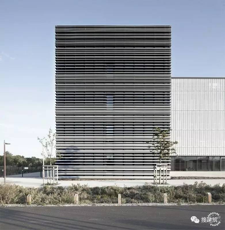

外墙一致性

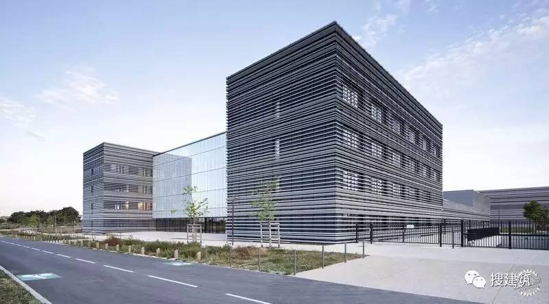

建筑规模的外墙构图遵循类似于Vercors地块的沉积过程。每个建筑都采用相同的系统,连接外部绝缘,确保高热性能,彩色金属包层,其色调与周围环境中发现的色调相呼应,以及系统的百叶窗水平面板,保护人体免受太阳辐射,同时集成所有通风系统 在实施过程中提供了很大的灵活性。水平刀片的不规则分布符合场地(办公室,实验室,技术空间等)的具体要求和约束条件,并为Ecotox中心提供独一无二的根植于其周围的视觉解读。
The composition of the fa?ade on the scale of a building follows a sedimentation process similar to that of the Vercors massif. Each building applies the same system that links an external insulation ensuring high thermal performances, a coloured metal cladding of which the tones echo those found in the surrounding landscape and a system of louvre horizontal panels that protects one from solar radiation while integrating all the ventilation systems and that offers great flexibility in its implementation. The irregular distribution of the horizontal blades answers to the specific requirements and constraints of the premises (offices, laboratories, technical spaces etc.) and offers for the Ecotox centre a visual interpretation that is unique and rooted in its surrounding.

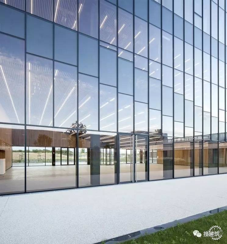

入口序列

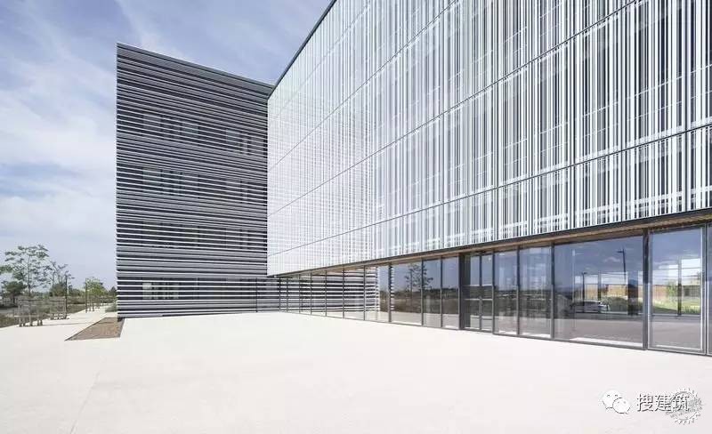

面板连续性的唯一例外,入口外墙的鼓膜是一个幕墙(结构玻璃窗系统),丝网印刷并与四层支撑壳梁相连。 高度暴露于太阳辐射,这个立面整合了太阳能烟囱的装置,以自然的方式通风300个会议室。
The only exception in the continuity of the panels, the tympanum of the entrance fa?ade is a curtain wall (structural glazing system), screen-printed and linked to supporting shell beams on four levels. Highly exposed to solar radiation, this fa?ade integrates a device of solar chimneys to ventilate in a natural way the conference room of 300 places.

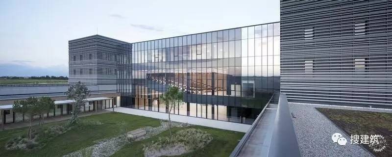

在花园一侧,让新鲜空气从花园进入,而热空气通过整合在象征着Ecotox中心展示柜的外墙的太阳能烟囱排到屋顶。在入口处延续下来,入口处是一个没有中间支持点的广阔空间,完全开放到室内花园。
On the garden side, pantograph openings let the fresh air enter from the garden while the hot air is evacuated to the roof through the solar chimney that is integrated in a fa?ade symbolising the Ecotox Centre showcase.In the continuation of the entrance court, and under the bleachers of the conference room, the entrance is a vast space without intermediary support points, completely open to the interior garden.

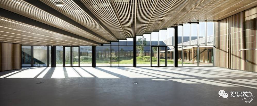

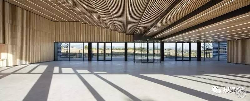

真正的交流和放松场所,在科学平台的十字路口,这个开放空间组织内部功能,并使中心的所有用户受益。
Real venue for exchanges and relaxation, at the crossroads of the scientific platforms, this open space organizes the internal functioning and benefits all the users of the centre.

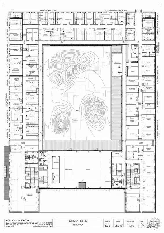

▲平面图

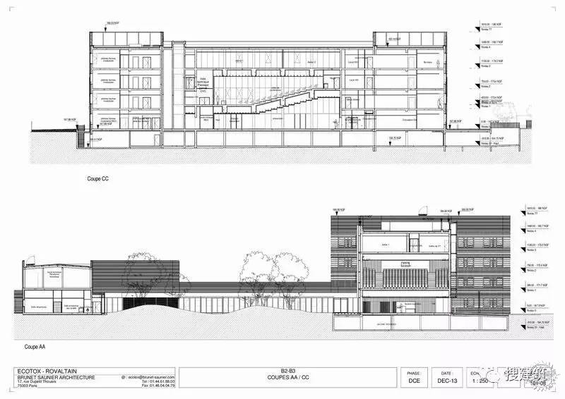

▲剖面图
