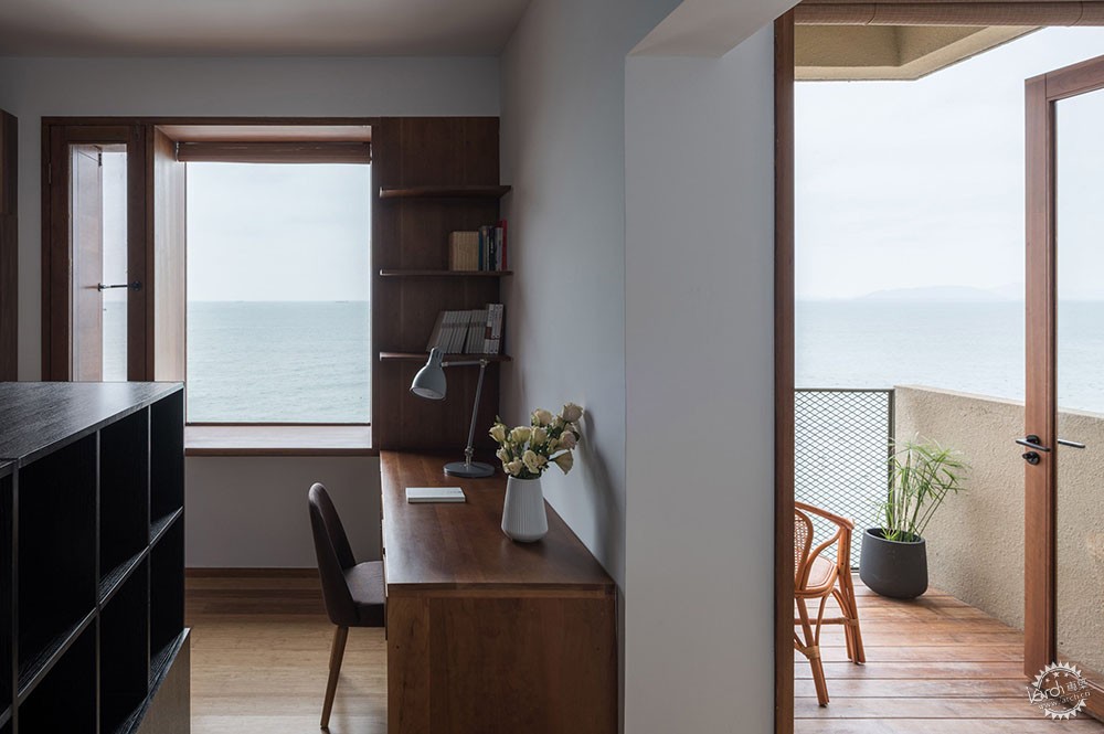

外墙的额外厚度还允许家具镶入其中,从立面中挖出窗洞放置窗户。
这些灰空间包含座位、搁架、桌子和其他配套的家具,使它们能够起到各种功能角色,以构建海景。
The additional thickness of the external walls also allows furniture to be incorporated in voids that are carved out from the facades to accommodate the windows.
These intermediary spaces contain seating, shelving, desks and other fitted furniture that enables them to perform various functional roles in additions to framing the sea vistas.
