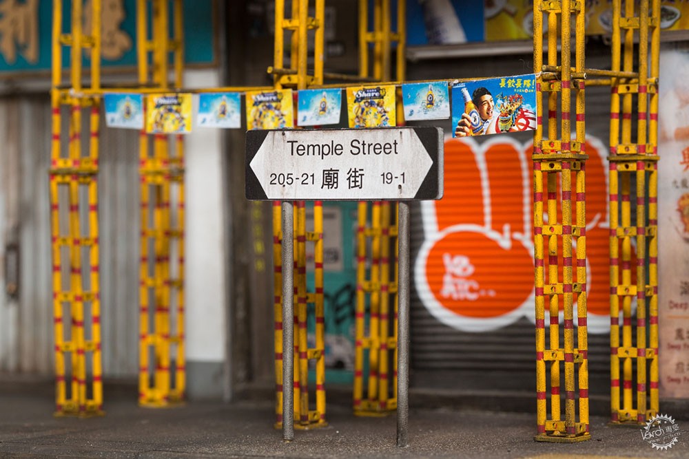

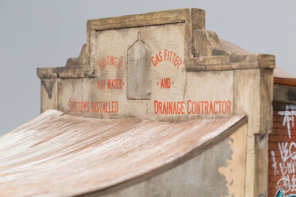

AD:和我们聊聊你的建模过程吧!

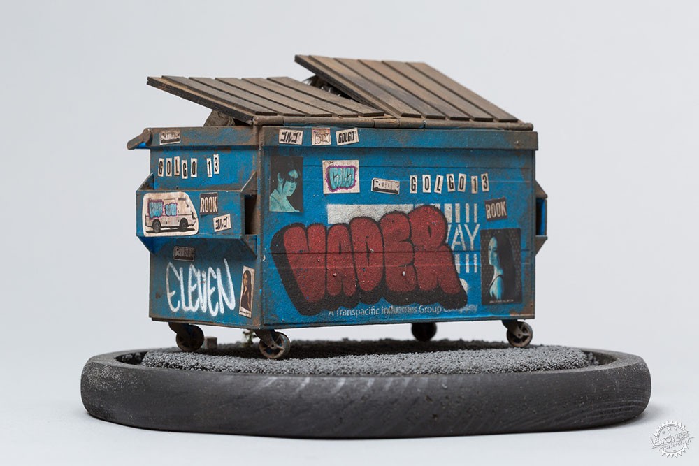

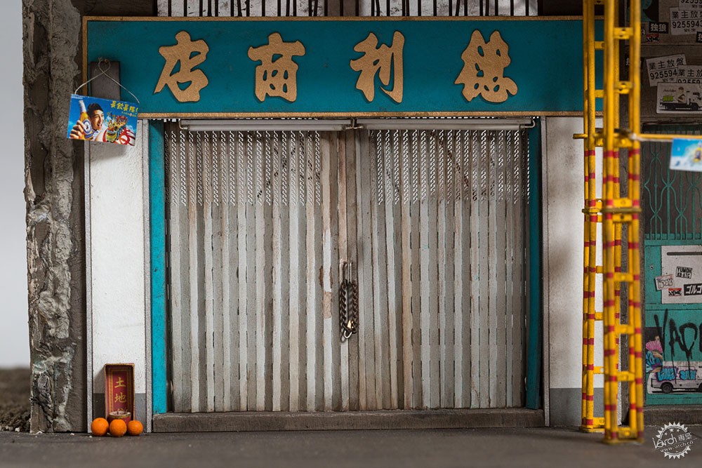

JS:首先,我会通过谷歌街景地图来寻找我想要制作的建筑原型。我会在脑海里先将这些建筑场景拆分成各个部分,例如门窗、街道、配电箱等等。然后我会开始思考应当运用哪些材料来制作模型,例如,用瓦楞纸做门,用纤维板制作建筑底座。在建筑基础逐渐成形,并具有真实感后,我会开始布置电力系统和外部照明设置,在某些情况下,我还会添加照明传感器。
你的模型比例有多大?
我一般只制作1:20比例的模型,因为我发现这是一个最容易计算的数字。我经常会留出一些譬如门窗或砖等小型构件的地方,运用PS软件来绘制建筑的剩余部分。我主要运用的材料是用于制作基础的纤维板、制作窗框的1毫米纸板,还有一些细部构件则运用黑色卡纸来制作,包括制作玻璃窗户的0.25毫米塑料板。然后通过喷漆、丙烯涂料、蜡笔来营造出建筑的真实效果。
制作一个模型需要花费多长时间?创造一个模拟现实的迷你模型有多重要?
时间的长短取决于建筑的性质。小的或者不那么复杂的模型一般几天的时间就足够了。我做过最久的模型是九龙缩影,整整花费了3个月的时间,每天的工作时间大约有8到16个小时,每周需要工作6至7天。我会尽可能地让作品看上去真实一些,我需要很多参考照片,并且尽量模仿每个细节,例如铁锈、污垢痕迹等。我想让观众在看到模型照片时能够信以为真。
你想成为一名建筑师吗?
在大学时我考虑过这个问题,但那之后我好像对建筑师有一些误解,我认为建筑设计包含细致的结构设计,需要充分考虑各个细部该如何搭接,事实上我当时并不知道有结构工程师的存在。所以我选择了平面设计,我的多项艺术作品都被展出,但我现在更愿意为建筑公司制作模型。
AD: Take us through your modeling process!
JS: First of all I find the building I want to replicate, either in person or using Google Maps Street View. From there I start to reverse engineer the building and break it down into components (i.e. the doors, windows, street, electrical boxes and so on). I then start working out which materials I will be using to create each component from scratch. Corrugated card, for example, for roller doors; MDF for the base of the building. Once I have the base built I lay down a base coat of paint and start weathering it using brushes and chalk pastels. It's during this stage that the building starts to look real and from here I start adding the wiring and the electrics for interior and exterior lighting and, in some cases, sensor activated lighting.
What scale do you work in?
I almost only work in 1:20 as I find it easier to do the calculations to create the scale version of the builds. I usually go off one small aspect, such as a door or a brick, and using Adobe Photoshop I work out the scale for the rest of the building. In terms of the main materials I use: MDF for the base, 1mm-thick cardboard for window frames, black card for more detailed areas, and 0.25mm-thick plastic card for windows. I use spray paint, acrylic paint and chalk pastels for painting and weathering the building to create the realism.
How long does each artwork take to produce? How important is creating a perfect mimic of reality?
It depends on the build. The smallest and less complex ones can take from a day to a few days to complete. The longest build, which was my Kowloon Miniature, took three solid months working on average six to seven days a week and eight to sixteen hour-long days. I strive to create a reality. I take as many reference photos as possible to mimic every single streak of rust, grime and chipping of stonework. I want viewers to be fooled, if I take a photo of the completed work in sunlight, to think it is the real thing.
Have you ever considered becoming an Architect?
It was something I considered when I was thinking of going to University but, back then, I was mistakenly under the impression that as an Architect I would have to design buildings which didn't fall down (I didn't realise that was more the role of engineers!). So instead I chose to study Graphic Design. My miniatures are mainly for artworks to be exhibited but I am now looking to create architectural models for firms.
