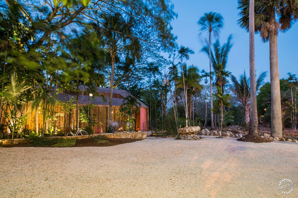

墨西哥建筑公司TACO设计了这座Portico Palmeto工作室,用作其办公总部,建筑运用了粉红色墙体、当地材料以及高大的百叶窗,充分地打开了室内空间。
这座建筑工作室面积1453平方英尺(135平方米),位于墨西哥尤卡坦半岛的一座历史城市Mérida。
Mexican architecture firm TACO has designed the Portico Palmeto studio to act as its headquarters, with pink walls, local materials, and tall shutters that open up the interior to its tropical setting.
The 1,453-square-foot (135-square-metre) rose-coloured building serves primarily as an architecture studio in Mérida – a historic city on Mexico's Yucatan Peninsula.

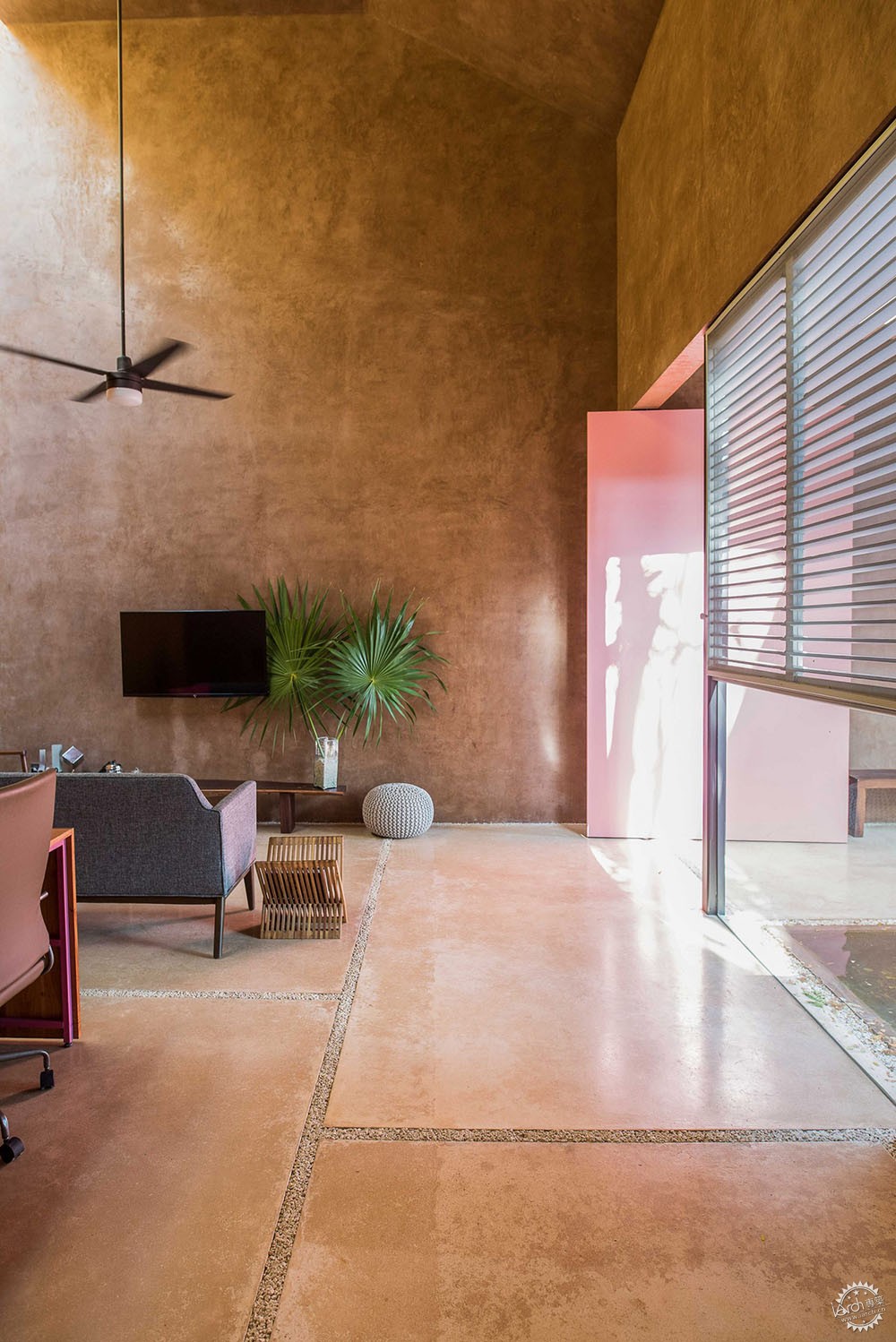

建筑师没有采用传统的办公场所设计方式,而是在建筑中塑造了更加简约、如家般温馨的工作氛围。
工作室负责人说:“建筑空间来源于传统办公原型场所,但我们更加着重地刻画室内体验,让其具有欢迎感和凝聚力。”
The architects wanted to stray from the notion of conventional workplaces and create a more homely atmosphere within the building.
"The spaces were designed away from a stereotype related to a traditional workspace, and focus on making the experience of working in it more welcoming and domestic," said the studio.

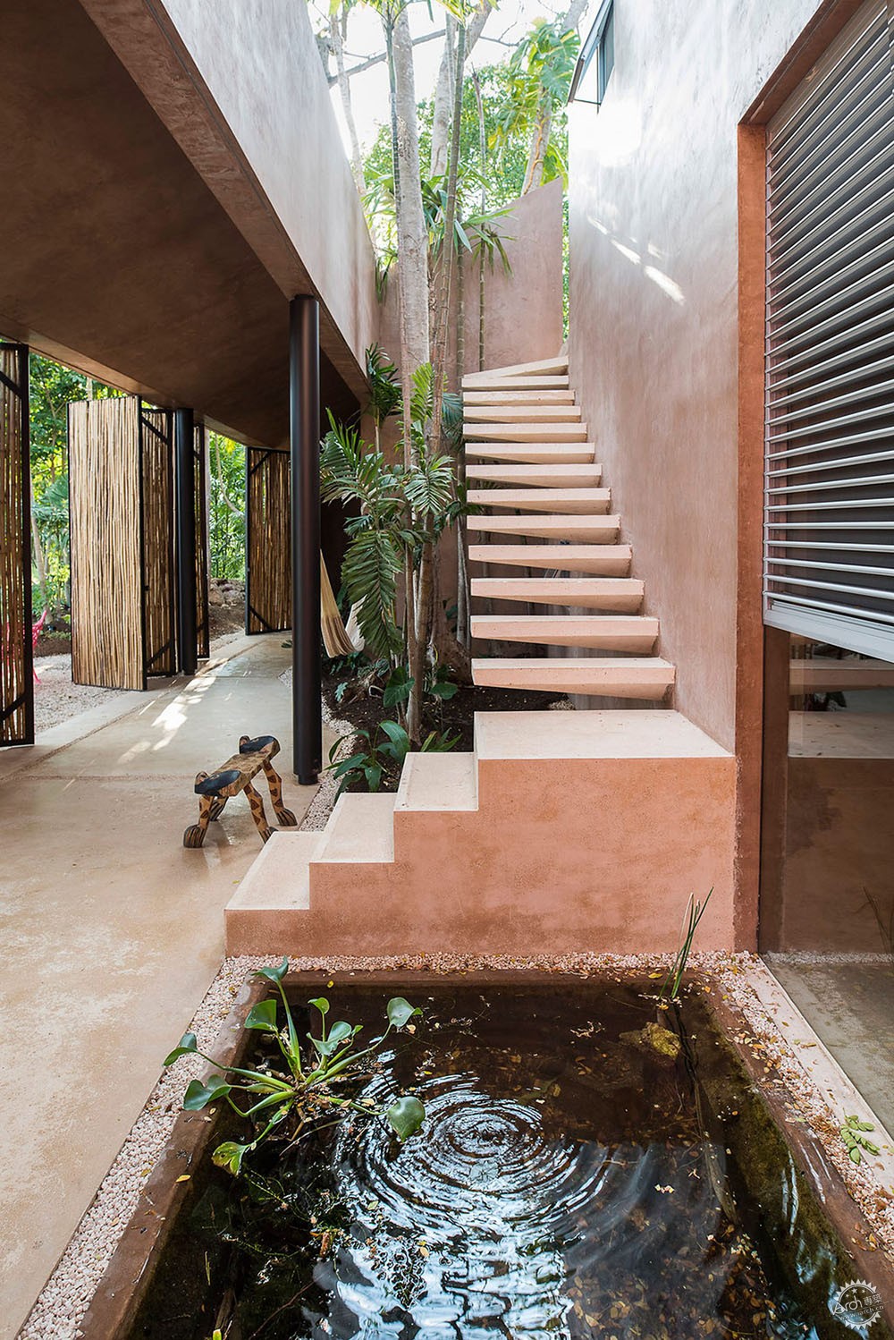

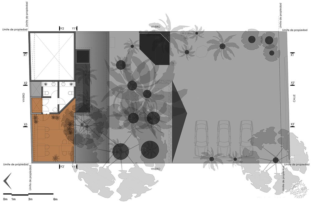

建筑一层是工作场所,并且设置有能够俯瞰庭院的厨房。使用者通过室外台阶可以来到起居室、浴室以及一个开放式屋顶露台。
On the ground floor are rooms for working, along with a kitchen that overlooks a small courtyard. Outdoor steps lead to living areas and two bathrooms, as well as an open-air roof terrace.

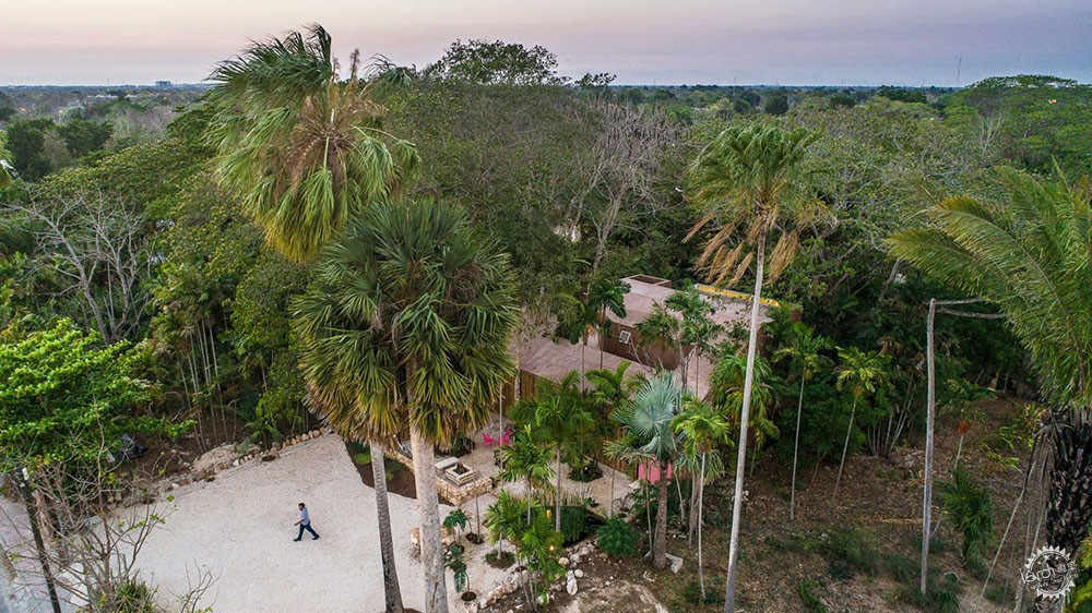

该项目又名为“Palmetum”,指的是场地上茂盛的棕榈树。许多树木与建筑相结合,建筑师甚至在天花板上挖空一个圆洞,让树干能够从中穿过继续生长。
Part of the project's name, Palmetum, means a place where palm trees flourish. Many of these have been integrated into the building, which has circular holes in the ceiling for the trunks to reach up through.

建筑附近有一座植物园“Vivero Cholul”,这座植物园位于历史上玛雅殖民区的中心地带。
TACO说:“针对参观者来说,我们可以通过工作坊的形式建立学术研究与建筑价值之间的联系。”
The structure is also located near a plant nursery, Vivero Cholul, in the heart of a historic Mayan-colonial community.

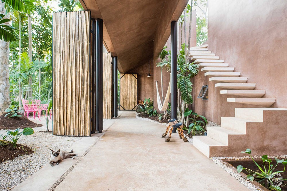

工作室的前部区域运用了当地生产的竹制面板,它们具有控制隐私、安全、透光的功能。
所有墙体与天花板粉刷着磨光的灰泥,并运用了场地上的生土。
The bamboo panels that run across the front of the studio – which open and close to control privacy, security, and sunlight – were produced locally.
Burnished stucco lines all of the walls and ceilings, and was naturally pigmented with the earth from the site.

建筑平屋顶通过防水混凝土浇筑而成,并且运用聚苯乙烯板进行隔热,而卫生设施则区分了不同用水功能。
施工材料的选择考虑了气候因素,并且这些材料能够经得起热带地区的高温与潮湿天气。地面由白色混凝土建造而成,其中设有一些缝隙,用于地面排水。
A flat roof was cast in-situ with waterproofed concrete and is thermally insulated with polystyrene panels, while hydrosanitary facilities separate grey and black water on-site.
Construction materials were chosen for their ability to weather naturally, and stand up to the heat and moisture of the region. White concrete lines the floors, with gaps among them to remove moisture from the ground.

建筑中运用了一些抗白蚁的硬质木材,以及有着铝制框架的钢化玻璃。室内空间包括防蚊网和水池,都能够抵御昆虫以及当地的动物群体。
Hardwoods were used for carpentry and are naturally resistant to termites, while windows comprise aluminium frames and tempered glass. All interior spaces include mosquito nets, with water pools also functioning to control insects, alongside native fauna.

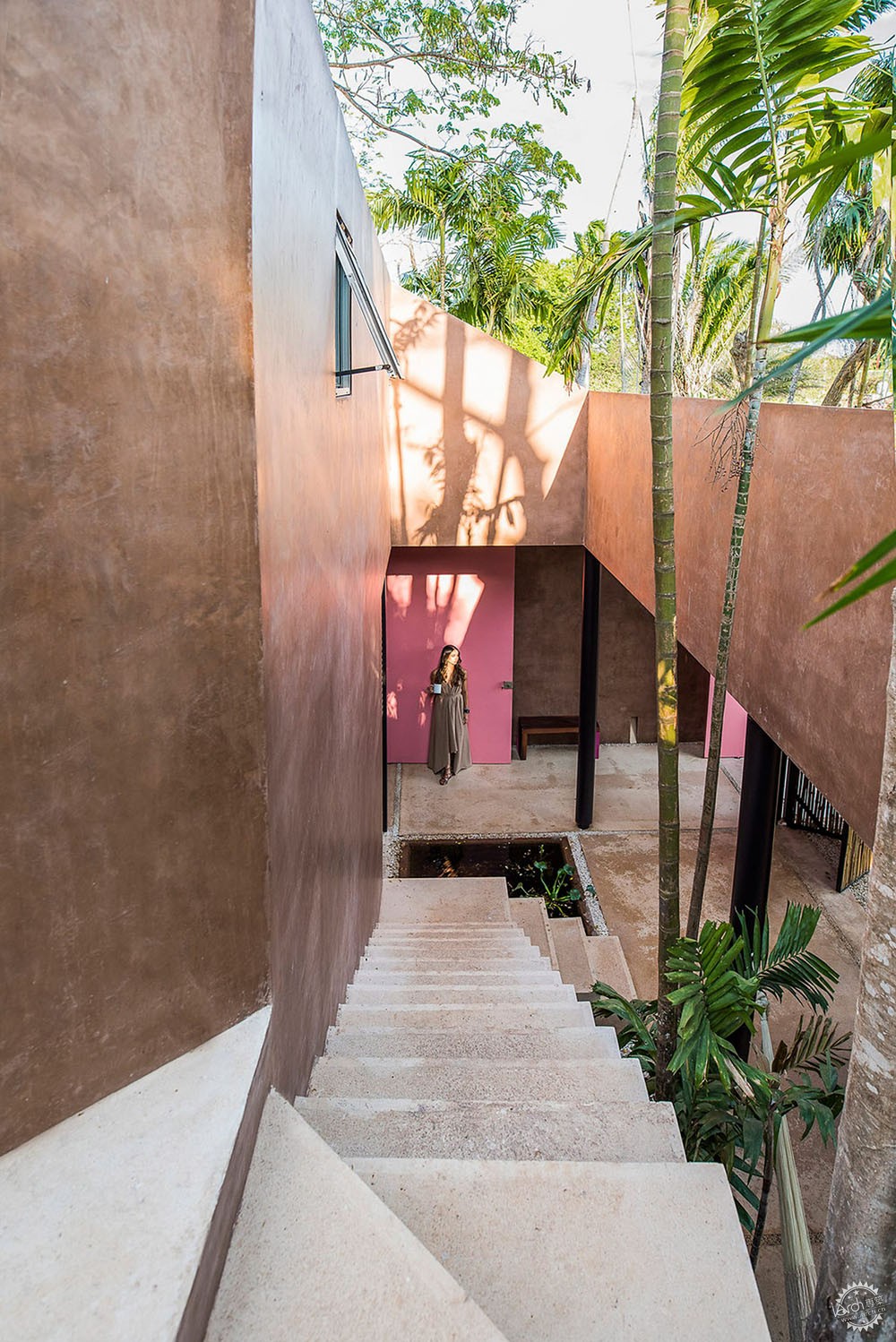

该项目中所运用的柔和粉色与当地的植物相呼应,同时能够吸引当地的鸟类和其他物种。
TACO说:“这座建筑融合了多种要素,这些要素抽象地表达了当地建筑遗产的特征。”
The soft, pink colours of the project were chosen to relate to the native vegetation, and to attract wild birds and other local species.
"Its aspiration is to be a syncretic building capable of abstracting the qualities of a regional architectural heritage," said TACO.
