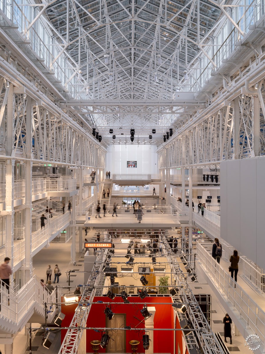

这座建筑的设计过程经过了全面的重新构思,但保留了其外部表皮。三英尺厚的砖石外墙已经涂上了石灰泥和浅灰色油漆。屋顶采用全玻璃材质,正如建筑师Bashkirov设想但从未实现的那样,RPBW通过引入钢檩条和拉杆的二级结构加强了现有的主钢桁架结构。玻璃同样是一项复杂的工程:底层的三倍绝缘玻璃和上层的夹层玻璃覆盖着光伏电池网格,覆盖面积为54000平方英尺,可以产生建筑所需10%的能量。由于俄罗斯首都冬天多雪,屋顶可以支撑超过3英尺厚的积雪。这个特殊的屋顶系统也可以向P\V电极发送一个小的电流来帮助融化冰雪,减轻屋顶负荷。
The building has undergone an extensive re-imagination in which the external shell is the main survivor. The 3-foot-thick external masonry walls have been coated with lime plaster and light grey paint finish. The roof is now fully glazed, as Bashkirov intended but never implemented, and RPBW reinforced existing primary steel trusses by introducing a secondary structure of steel purlins and tension rods. The glazing is an equally complex piece of engineering: A lower layer of triple-insulated glass and an upper layer of laminated glass are covered with a grid of  photovoltaic cells, 54,000 square feet in size, that should produce up to 10 percent of the building’s energy. Because of the snowy long winters in the Russian capital, the roof can support over 3 feet of settled snow. This particular roof system can also send a small electrical charge into the p,v. cells to help melt the icy weight.

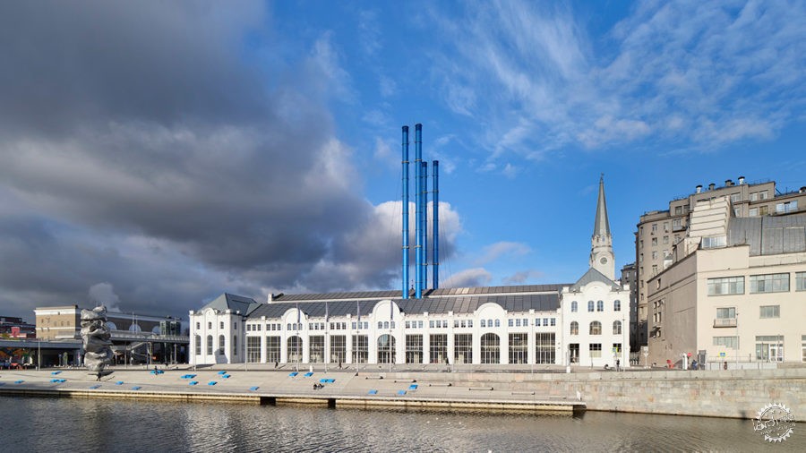

这些穿透莫斯科天际线的亮蓝色烟囱取代并重新定位了先前的发电站。皮亚诺说:“砖砌的烟囱太旧了,所以我们建造了新的作为象征,并把它们漆成马蒂斯的蓝色。你需要爬到230英尺高的地方才能得到干净的空气,新的烟道把新鲜空气引入大楼的被动通风系统,而不是散发出烟雾。
Those bright blue chimneys penetrating the Moscow skyline replace and reposition the power station’s previous ones. “The brick chimneys were too old, so we built new ones as a symbol and painted them Matisse blue. You need to go 230 feet up to get the clean air”, Piano says of the new flues that draw fresh air into the building’s passive ventilation system, rather than exuding fumes.

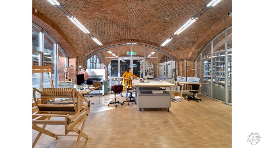

在项目实施的整个运行周期中,电站被密集的工业建筑所包围,其中大多数已经被清除,以恢复GES-2曾经拥有的周边环境。建筑师Matthew Daubach解释说:“我们在拆除的同时进行设计。只有移除多余的工业建筑才能充分展示空间的潜力。没有比砖砌拱顶库房与主楼相邻更典型的例子了,主楼位于一个类似桥墩的人行平台下面。”当皮亚诺第一次来到这里的时候,这里有一座五层的办公大楼,他一进去就发现了曾经用来蒸馏皇冠伏特加的一层拱顶库房。RPBW拆除了上面的办公室,库房现在变成了3D打印、金属制品、纺织品、陶瓷和木制品的作坊。
Throughout its operating life, the power station had become hemmed in by a dense amalgamation of redundant industrial buildings, most of which have been cleared away to return the surrounding spaces GES-2  once had. “We were designing while demolishing,” explained fellow architect Matthew Daubach, explaining that only by removing industrial accretion was the full spatial potential revealed. There is no clearer example of this than with a block of brick vaults running adjacent to the main building, which sat underneath a pier-like pedestrian platform. When Piano first visited the site there was a 5-story office block here, and only upon entering did he discover ground-level vaulted rooms once used to distill Smirnoff vodka. RPBW demolished the offices above  and the  vaults now enclose workshops for 3D printing, metalwork, textiles, ceramic, and woodwork.

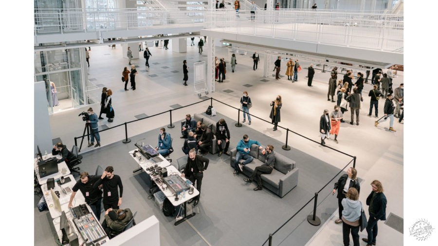

在将内部空间剥离出外壳后,RPBW开始构建新的内部体量。从河岸方向进入,游客站在一个巨大的内部广场上,从办公室、教室和图书馆都可以俯瞰到广场。楼梯通往衣帽间、厕所和传统的画廊空间。当游客继续进入室内,另一个洞穴般的空间被打开,这次是一个晶体似的空间,一个带有龙门和高层走道的轴向空间,所有这些空间都是可调节的和未规划的,供未来艺术家探索。
After stripping the space back to a shell, RPBW set about constructing new internal volumes. Entering from the riverbank a visitor stands in a vast internal piazza, which is overlooked by those in offices, classrooms and the library. Stairs lead down to the cloakroom, toilets, and traditional gallery spaces. As the visitor continues through the interior, another cavernous space opens up, this time a Crystal- Place- like axial space with gantries and high-level walkways, all available and un-programmed for future artists to explore.
