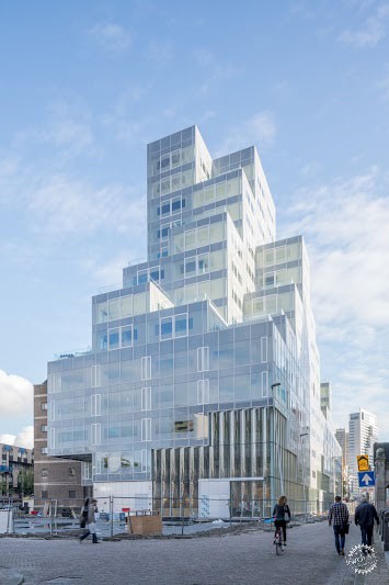

鹿特丹Timmerhuis多功能大楼为市政厅新大楼,将容纳市政服务设施、办公室和住宅单位。OMA的设计把Timmerhuis构想成模块式建筑,模块反复向上堆砌成不规则双塔顶建筑,位置越高,模块就越往内退。Timmerhuis拥有由小型单元组成的建筑外型,在Coolsingel大道(鹿特丹一条主干道)看过去复杂而震撼;而此建筑物与Stadstimmerhuis(建于1953年的市政建筑)相邻的两侧,则彰显出微妙细腻且相互融和的处理。
Timmerhuis的结构系统设计创新,使施工和功能布局同样变得高效又灵活:模块可按需要改装成办公空间或住宅。高层设有绿化阳台,可在鹿特丹市中心的城市环境中打造出附带花园的住宅。在地面层,结构模块悬于街面之上而非入侵剩余的空间,街道因而能享有广阔的开放空间,促使Timmerhuis和鹿特丹市之间能有活泼而开放的互动。
设计任务书规定Timmerhuis必须成为全荷兰最环保的建筑。为满足这项要求,OMA以灵活性作为大楼的核心概念,并设计了两个充当绿肺的大型中庭。两个中庭均连接气候系统,夏季储热而冬季蓄冷,再按需要释放冷气或暖气。大楼的三层玻璃幕墙应用高科技的半透明隔热层,达到前所未有的能源效率。
鹿特丹过去尽是修正主义规划,建筑风格毫不和谐;Timmerhuis并不期望成为这建筑史上的又一标志性建筑,反而试图以其性质模糊的体量成为周边现存建筑之间的缓冲。现有的市政厅和邮局之间的轴线与Timmerhuis的对称轴重叠,而市政厅和邮局之间的街道也延伸成为通往Haagseveer大道的通道。Timmerhuis与旁边的Stadtimmerhuis保持一样层高,两者因而谐和融合,而基座也配合周边劳伦斯区的特色而设计成20米高。

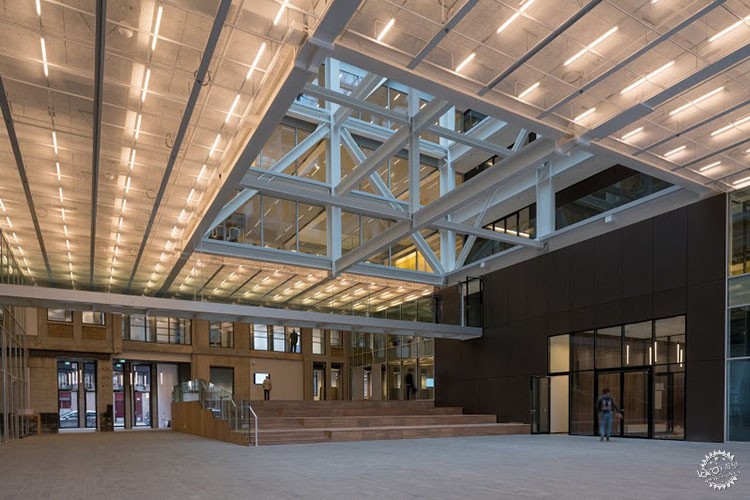

悬臂钢结构释放了地面空间,使之成为毫无阻隔的公共空间,既打造出宽阔的公共通道,鹿特丹博物馆也搬到此处。

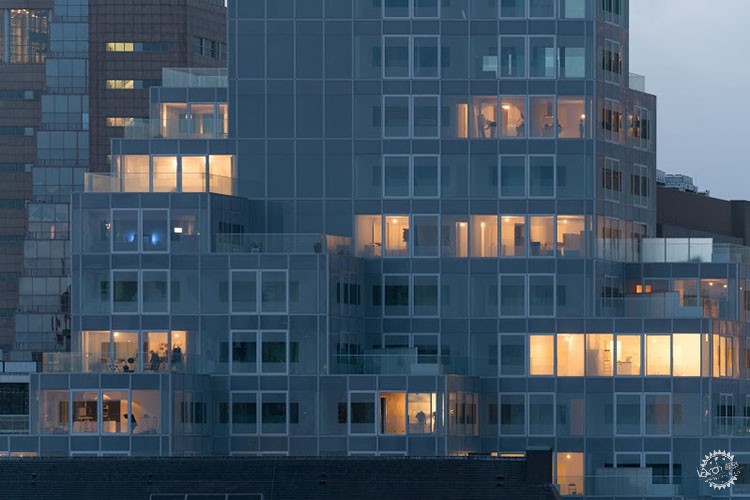

For Rotterdam's Timmerhuis, a new building for the city hall that accommodates municipal services, offices, and residential units, OMA conceived a modular building with repeated units gradually set back from the street as they rise into two irregular peaks. The building's composition of smaller cells creates an impressive, complex form when viewed from Coolsingel, one of Rotterdam’s main arteries, and allows for subtlety and adaptability as the new building meets the Stadstimmerhuis (a municipal building, from 1953), which surrounds it on two sides.
The Timmerhuis’s innovative structural system generates maximum efficiency and versatility both in construction and in program: units can adapt to either office space or residential parameters as desired. Green terraces on higher levels provide the possibility of an apartment
with a garden in the heart of urban Rotterdam. On the street level, the structure allows for generous open space, with modules overhanging rather than encroaching into an interstitial area, encouraging an active and open engagement between the Timmerhuis and the city.
The design brief stipulated that the Timmerhuis must be the most sustainable building in the Netherlands. OMA tackled this imperative through the building’s core concept of flexibility, and also through the two large atriums, which act like lungs. They are connected to a climate system that stores warmth in summer and cold in winter and releases this energy as warm or cold air as required. The building’s triple glazed curtain wall facade uses hi-tech translucent insulation that allows for unprecedented energy efficiency.
Rather than being yet another statement in Rotterdam’s crowded history of revisionist planning and cacophony of architectural styles, the ambiguous mass of the Timmerhuis tries to mediate between the existing buildings surrounding it. The axis between the existing town hall and the post office coincides with the axis of symmetry of the Timmerhuis, and the street between these two buildings continues into a passageway to the Haagseveer. The Timmerhuis integrates with the neighboring Stadtimmerhuis by maintaining the same floor heights, while the plinth height of 20m conforms to the character of the surrounding Laurenskwartier.

The cantilevering steel structure allows the uninterrupted unfolding of public space on the ground floor, home to a large public passage and the new location for the Museum Rotterdam.

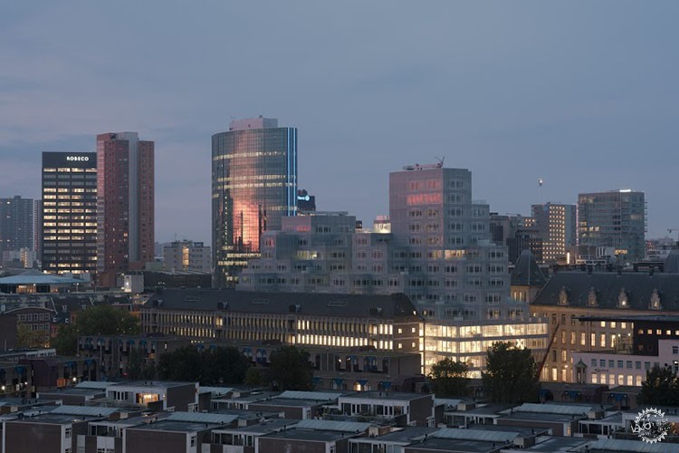

Timmerhuis多功能大楼/OMA第1张图片
Photograph by Ossip van Duivenbode, Courtesy of OMA

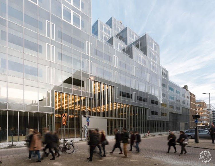

Timmerhuis多功能大楼/OMA第2张图片

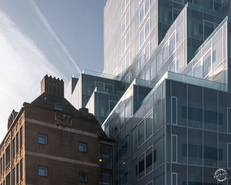

Timmerhuis多功能大楼/OMA第3张图片

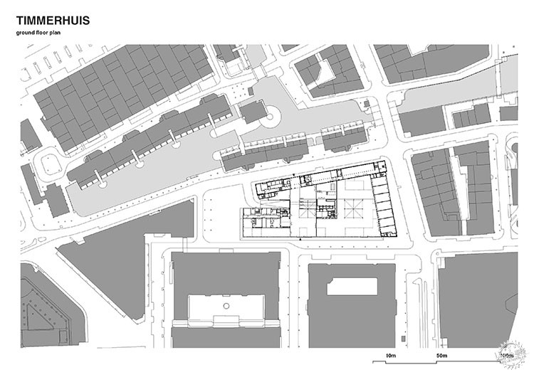

Timmerhuis多功能大楼/OMA第20张图片
首层平面图Image courtesy of OMA

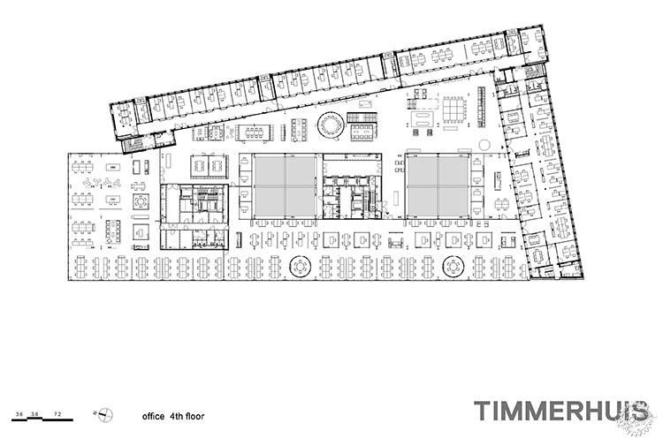

Timmerhuis多功能大楼/OMA第23张图片
四层平面图Image courtesy of OMA

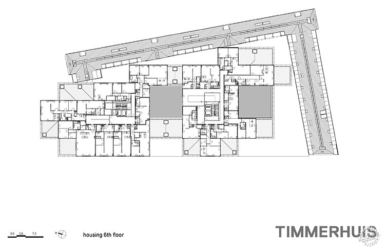

Timmerhuis多功能大楼/OMA第25张图片
六层平面图Image courtesy of OMA

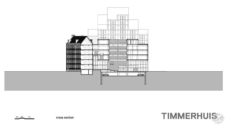

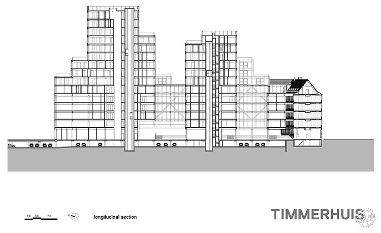

Timmerhuis多功能大楼/OMA第27张图片
剖面图Image courtesy of OMA
