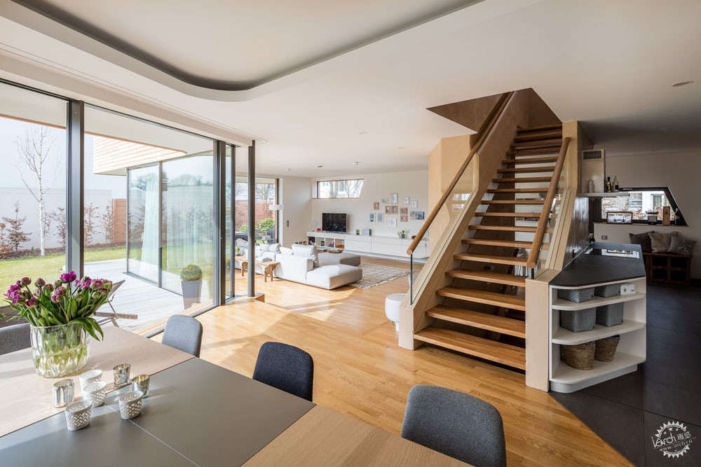

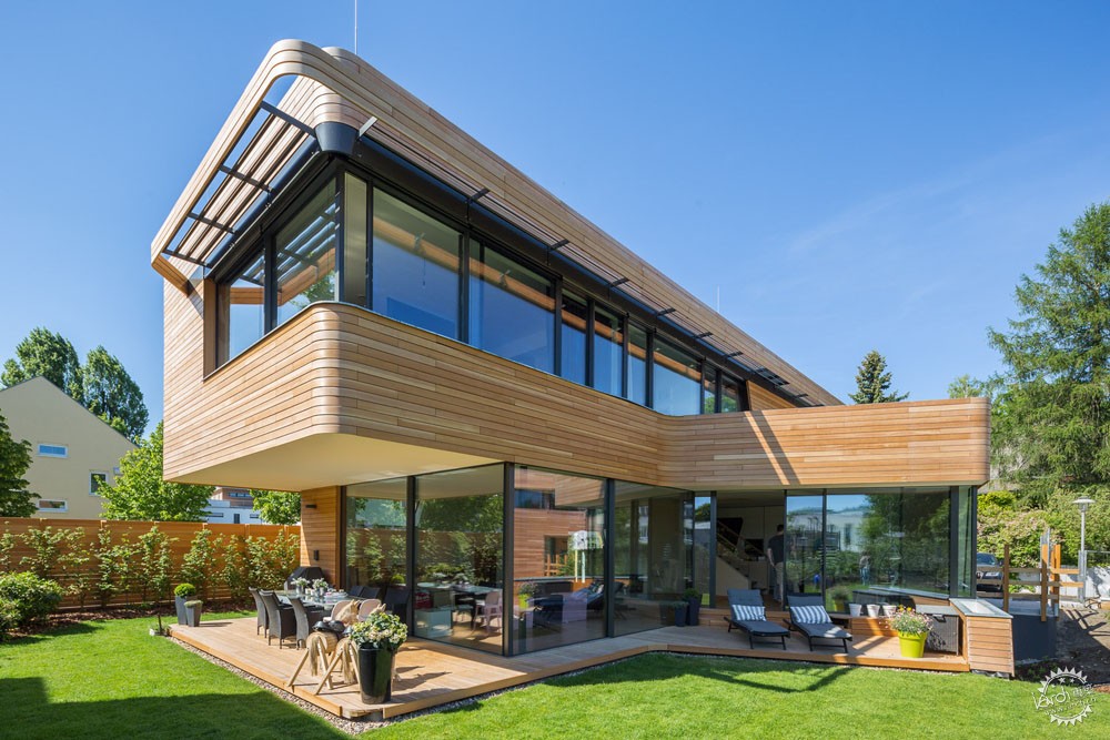

来自建筑事务所的描述。GRAFT事务所设计一座独户住宅和两座半独立住宅,它们都是注入流动性、能量和健康的生态建筑。项目使用无与伦比的整体方法,结合了现代建筑风格、新颖建筑设备、电动交通以及可持续性和身体健康。该住宅甚至产生剩余能量,用来给居住者租用的电动汽车充电。
From the architect. GRAFT designed a single-family house and two semi-detached houses, all of them environment- friendly buildings that join mobility, energy and health. The project is an unrivaled holistic approach that connects modern architecture, innovative building equipment and e-mobility as well as sustainability and physical health. The houses even generate a surplus of energy that will be used to charge an e-car that the tenant rents with the house.

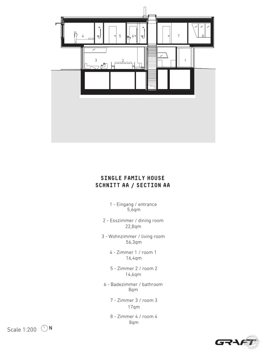

Section/截面图

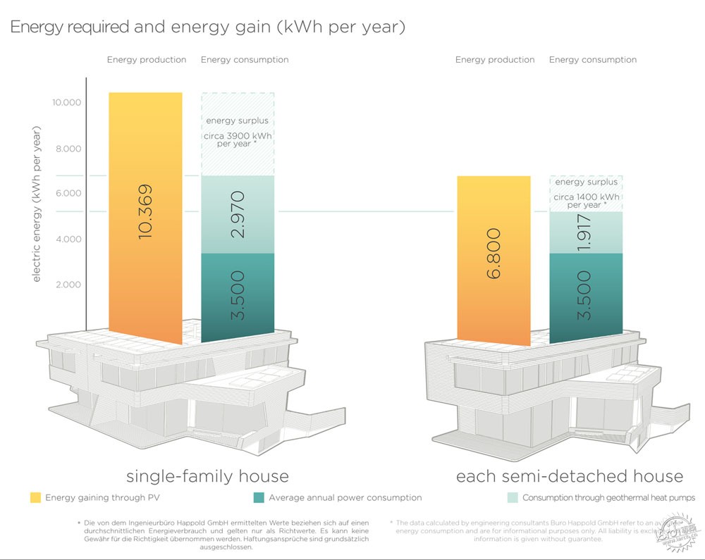

每座建筑都有三层玻璃和隔热外层,包含地窖,都是为了防止热桥。项目有地板供暖系统和机械通风,后者带有居住者能控制的高效热回收系统。
此外,屋顶光伏系统产生一些电能。房屋的总能耗少于光伏元件获得的能源。
In each building there is triple glazing and thermal-insulated envelope containing a cellar, all in order to prevent thermal bridges. There is a floor heating system as well as a mechanical ventilation with a highly efficient heat recovery system that the residents can control.
Furthermore, some of the electricity will be generated from a photovoltaic system on the roof. The total energy consumption of the house is less than the harvest from the PV elements.

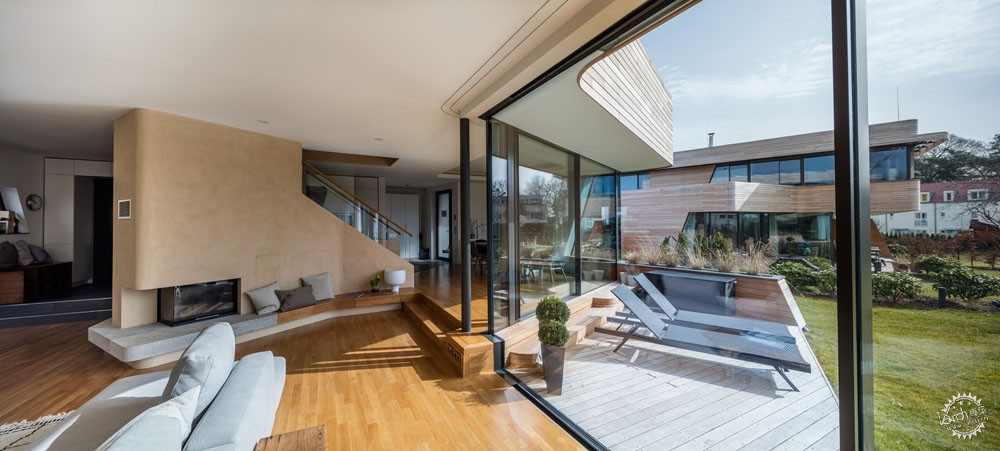

作为特殊特色,剩余能量能用来给居住者租用的电动汽车充电。
As a special feature this surplus of energy can be used to charge an e-car that the tenant rents together with his house.

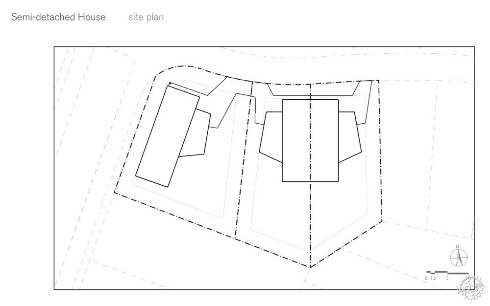

Site Plan/场地平面图

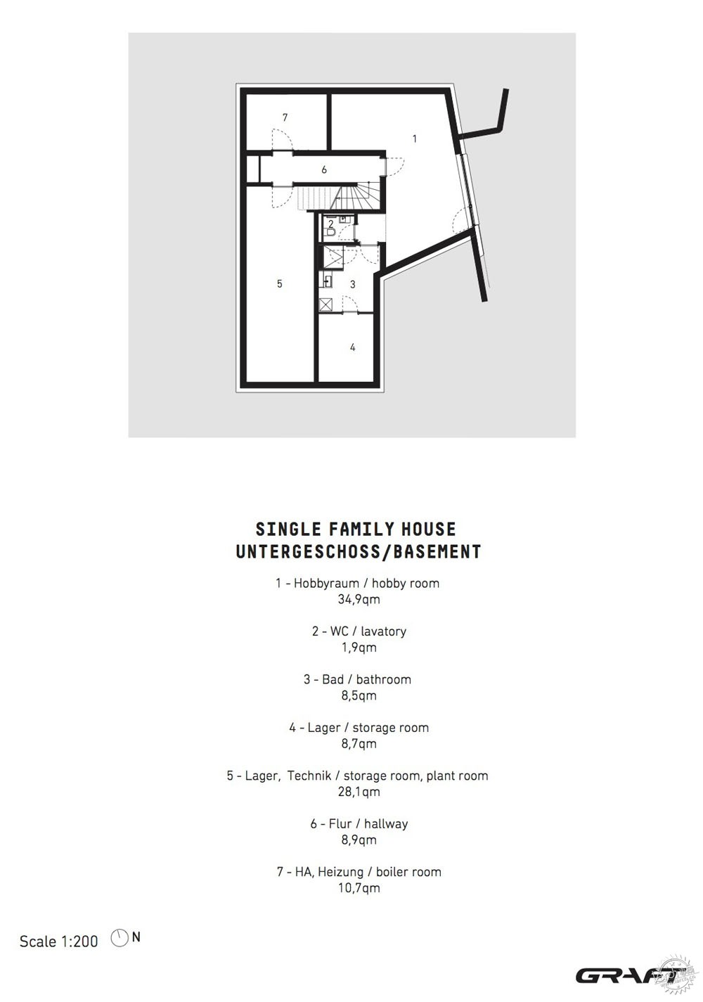

整体化住宅/ GRAFT第18张图片
Floor Plan/平面图
