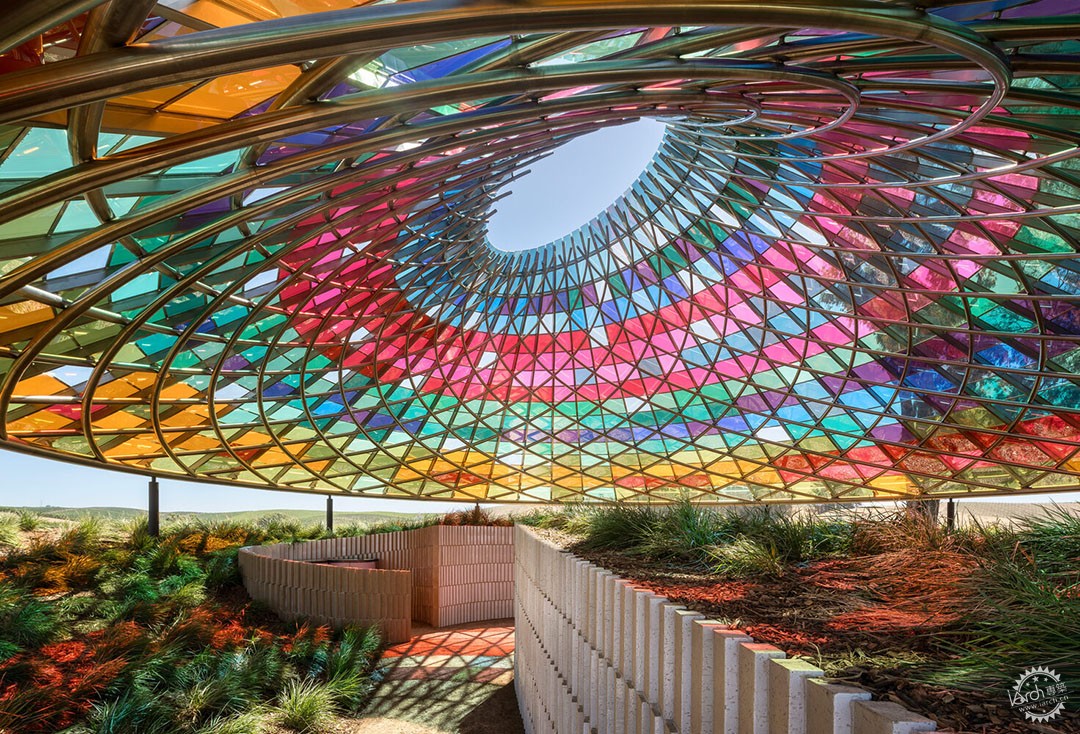

受自然色调启发的 PVB 夹层氛围

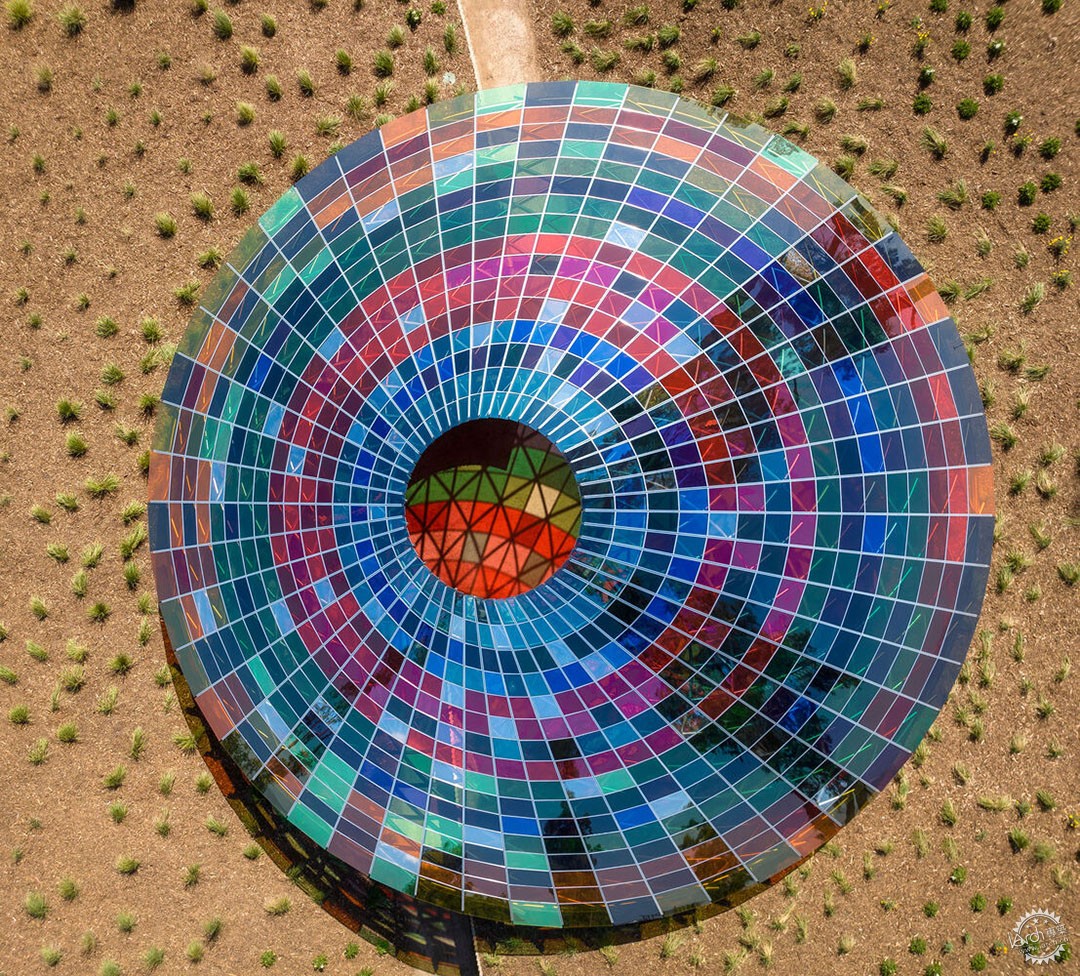

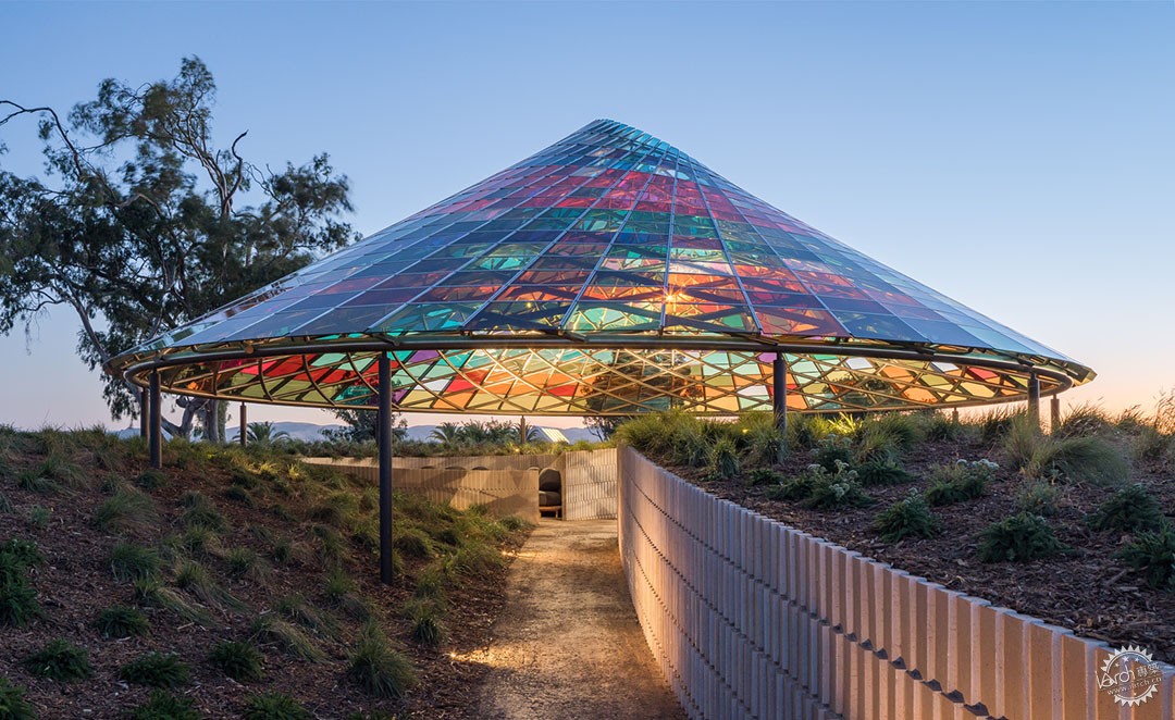

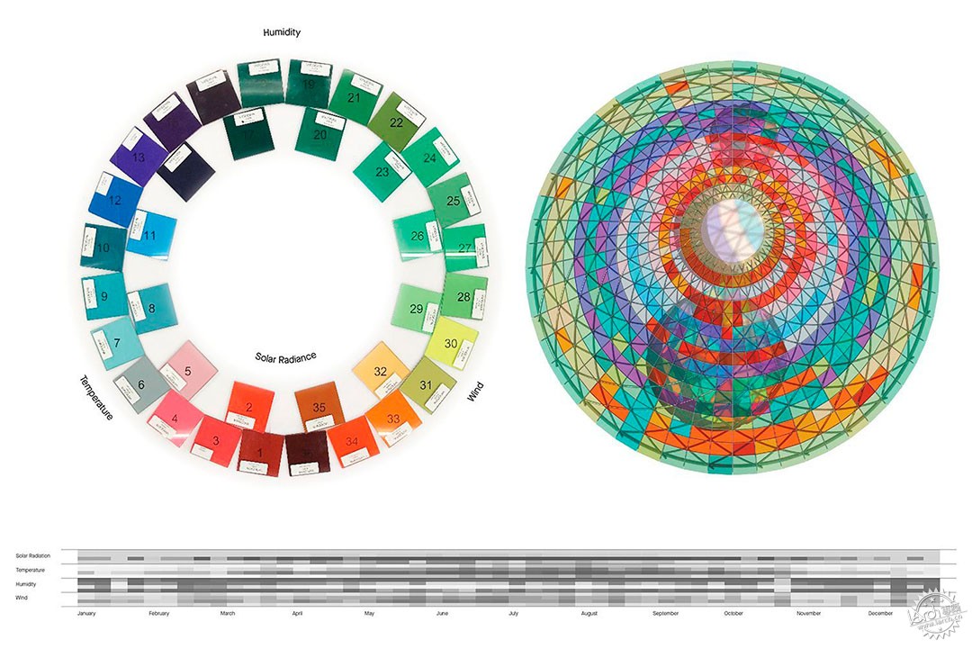

这个建筑由 Other Spaces工作室设计,呈现的是一种艺术的融合,展示了这里的资源,描绘了葡萄园的生命周期。作为景观的焦点,展馆采用圆形和方形空心钢材组合,安装在螺旋底座的环形梁上,采用 Vanceva PVB 夹层技术,在 832 块夹层玻璃面板上形成 24 种不同的透明色调。这些颜色包括绿色、金色、红色、酒红色、紫色和蓝色,代表了这里天气日历的四个气象参数:太阳辐射、风力强度、温度和湿度。

An Atmosphere of PVB Interlayers Inspired by Natural Hues
Designed by Studio Other Spaces, the pavilion was envisioned as a fusion of art, showcasing the region’s resources and depicting the vineyard’s lifecycle. Serving as the focal point of the landscape, the pavilion uses a combination of circular and square hollow steel sections mounted on a spiral-base ring beam featuring 832 laminated glass panels with 24 variations of transparent hues using Vanceva PVB interlayers. These colors—including shades of green, gold, red, burgundy, violet, and blue—represent the four meteorological parameters of a regional weather calendar: solar radiance, wind intensity, temperature, and humidity.

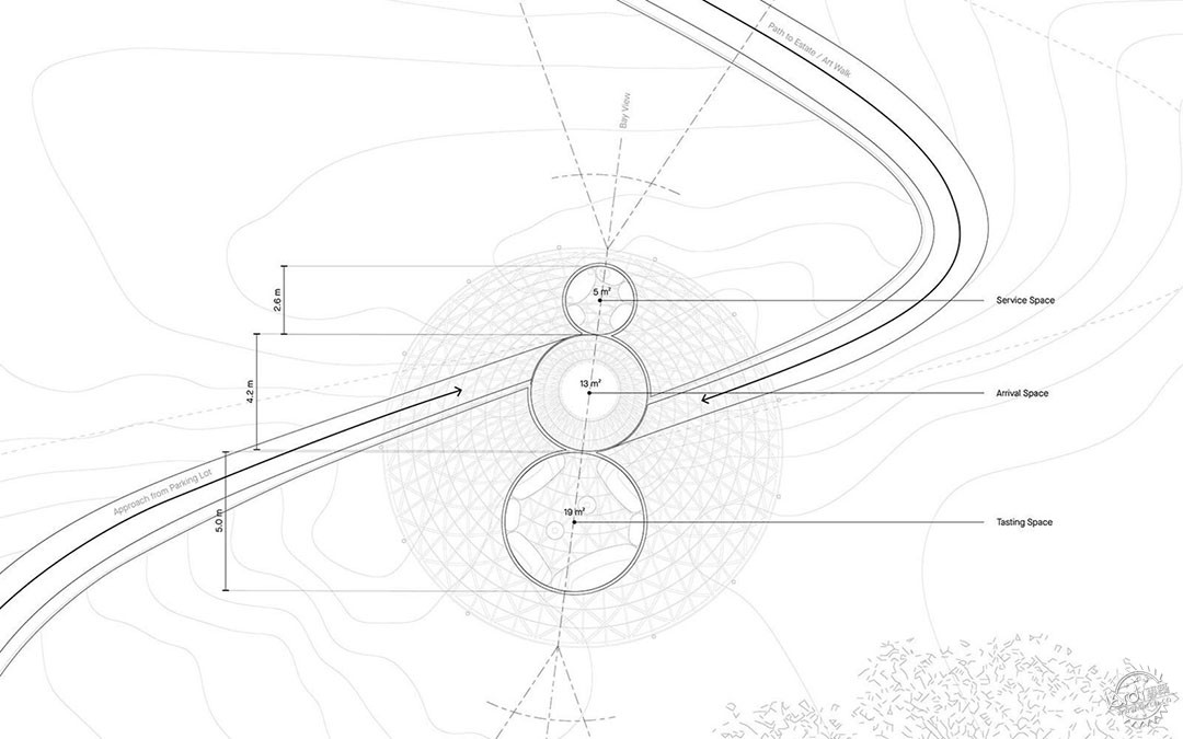

伴随着展馆营造出的一种氛围,让周围的环境逐渐显露,同时在地下凿出三个圆形空间,用于举办品酒活动:一个 13 米长的接待大厅、一个 19 米长的较大品酒空间和一个 5 米长的服务空间。

As the pavilion creates an atmosphere where the surroundings are gradually revealed, three circular spaces are carved into the earth to host wine-tasting events: a 13-meter arrival space, a larger 19-meter tasting space, and a 5-meter service space.

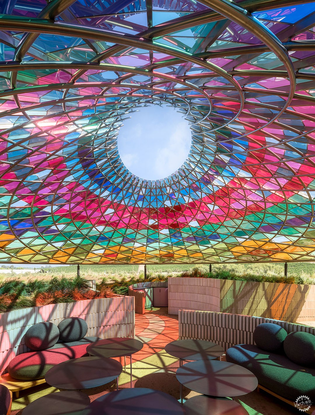

彩色的玻璃面板将游客的视线吸引到顶篷开放的顶点,将他们与天空连接起来。在顶棚下方,低矮的休闲座椅让游客可以将这里的地标全景尽收眼底,包括索诺玛山谷、圣巴勃罗湾、Domaine Carneros 酒庄以及展示 50 件特定地点艺术作品的 Donum 收藏馆。

The colorful glass panels draw visitors' attention to the open apex of the canopy, connecting them with the sky. Below it, low lounge seating offers panoramic views of the iconic areas in the region, including Sonoma Valley, San Pablo Bay, Domaine Carneros winery, and the Donum Collection featuring 50 site-specific artworks.

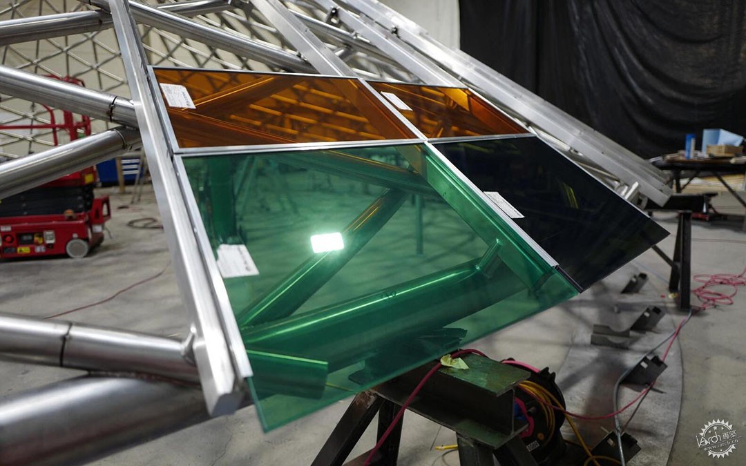

在施工过程中,顶篷的大部分组装工作都在场外进行,由 König Glasbau 公司生产夹层玻璃板。玻璃板之间最多可组合四种颜色的 PVB 夹层,从而形成 24 种色调。
此外,为了实现玻璃和钢框架之间的无缝衔接,每块玻璃板都由一个定制的铝框固定,并通过定制的 U 型槽钉在支撑结构上。这样的设置使玻璃板对齐而不重叠,既保持了每块玻璃板的纯色,又能确保正常排水。这种设计可以适应热胀冷缩,使玻璃板可以单独移动。
For the construction, much of the canopy's assembly took place off-site, where König Glasbau manufactured the laminated glass panels. Up to four color PVB interlayers were combined between the glass panels to create 24 shades.
Furthermore, to achieve a seamless interface between the glass and steel framing, individual glass panels were held by a custom aluminum frame and pinned to the bracing structure on a custom-made U-channel. This setup allowed the glass panels to align without overlapping, preserving the pure colors of each panel and ensuring proper water drainage. This design allowed for thermal expansion and contraction, enabling the panels to move individually.

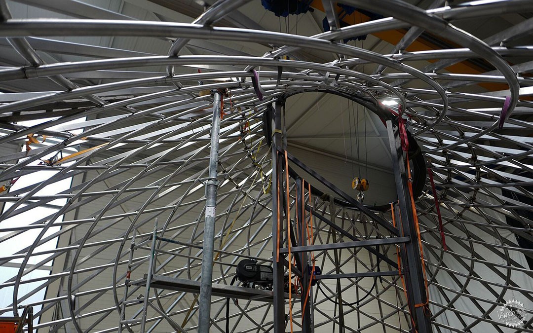

由于顶篷是由安装在螺旋底座环梁上的圆形和方形空心型钢组合而成,因此支撑部分的直径从 76 毫米开始,随着上升逐渐减小到 38 毫米,每隔一个接合点就会发生分段移动,大约每隔 1.5 米的钢材长度就会发生一次移动。这样,顶篷的重量负荷就会向下转移到位于 12 根外包结构柱上的插销连接点上。

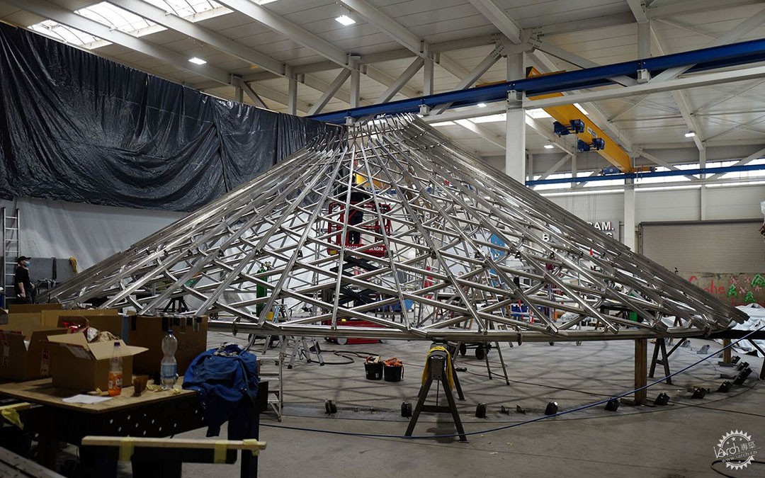

在将设计渲染成三维模型并送去制作之前,建筑师使用 Grasshopper 对其进行了优化。公司采用临时插销连接的方式制作了复杂的钢格栅框架,可以方便将整个结构从车间运送到现场。在焊接和安装彩色面板后,屋顶结构被吊装到合适的位置。
As the canopy is a combination of circular and square hollow steel sections mounted on a spiral-base ring beam, the diameter of the brace sections starts at 76 millimeters and decreases to 38 millimeters as they ascend, shifting in sections at every second joint, which occurs approximately every 1.5 meters of steel length. Thus, the weight load of the canopy is transferred downward onto pin joints that sit on 12 clad structural columns.
The design was optimized using Grasshopper before being rendered into a 3D model and sent for fabrication. The company fabricated the complex steel lattice framework using temporary pin jointing so that the entire structure could be transported from the workshop to the site. After welding and installing the colored panels, the roof structure was hoisted into place.
