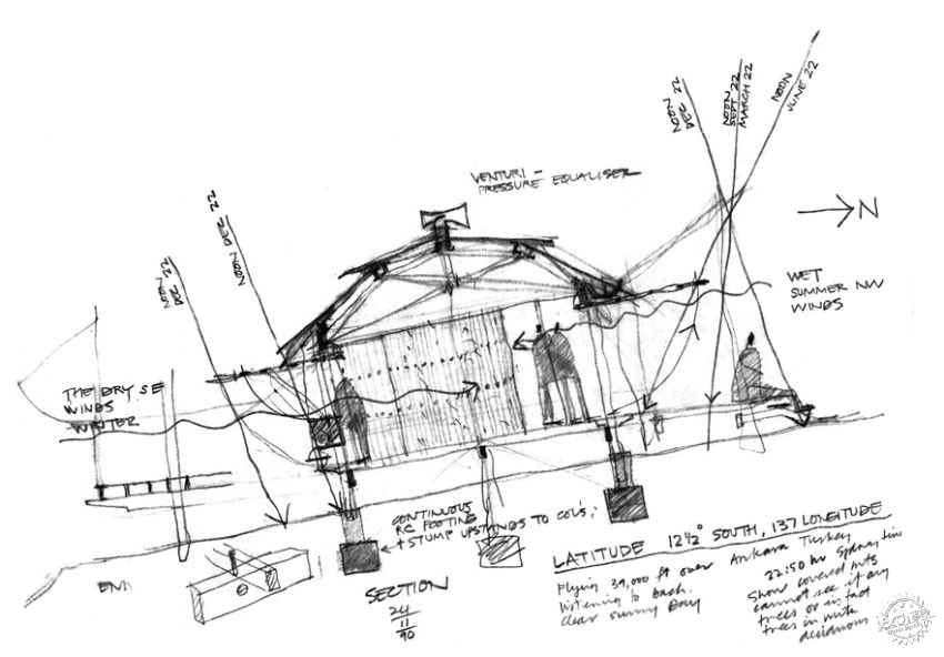

设计师以建筑原型为构思,设计了一个小窗口,适应于土著居民公共住房典型的砖建筑。在悉尼以北戈斯福德,所有的建筑部件都是由两个集装箱包装并且通过半挂车和驳船运到现场,并用螺栓连接在一起的,整个建筑过程花费了四个月的时间。
该建筑是由基本元素构成。屋顶用干燥的木材建成,还有可操作的外层结构。其结构体系是钢框架和澳大利亚硬木。精细的金属板屋顶占主导地位,深檐设计可以保护室内在夏季免受太阳直射。外墙为精雕细琢的填充板,没有玻璃开口。这些胶合板板条木材可以滑动或转动,便于微风吹入室内,自然冷却房子。
It was conceived by Murcutt as a prototype and as a viable alternative to the house then occupied by the clients, a brick building with small windows typical of aboriginal public housing in this context. Prefabricated in Gosford, north of Sydney, all components were packed in two shipping containers and transported to site via semi-trailer and barge. The house was bolted and screwed together on site, the entire process taking four months.
The building is elemental. A pitched roof, dry timber platform and operable skin float in relation to each other. The structural system is comprised of a steel frame and Australian hardwoods. The fine sheet metal roof is dominant, deep eaves protecting the interior from summer sun. The exterior wall is treated as finely crafted infill panels with no glazed openings. These typically plywood and slatted timber screens slide or pivot open allowing prevailing breezes to naturally cool the house.
